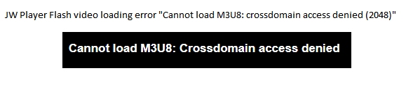

Unread postby Rick Calkins » Tue Jul 04, 2017 3:58 pm
Lack of Broadband is Not the Problem with Camera 3
Crossdomain Access Denied.jpg (24.69 KiB) Viewed 11692 times
Tim:
The Friends do not have a broadband deficiency problem. It was an unfortunate coincidence that the VOIP reservation system was in heavy use when the depot camera went down. You observe a broadband deficiency when the spinning arrow seen in the center of a monitor spins for a longer and longer period of time, before the contents are loaded and available for viewing. This did not happen with the three cameras. Actually, the camera displayed the problem, “Cannot load M3U8: Crossdomain access denied.” (See screen grab above)
The problem you are having with the Station Camera is improper coding communicated with JW Player, your video host. The code now in use disallows the loading of the video requested. There are times when downloading a video by a non-authorized domain is an important security measure. But, that is not the case here. It appears that all domains are excluded rather than included.
The use of JW Player gives you full control over retaining visitors who watch the train cameras. When viewing a video with JW on the Cumbres Toltec website, the user remains at the Cumbres site when the video is completed or exited. If the user is linked to that video on YouTube from the Chama Toltec website, that viewer then remains at YouTube after viewing is over. The user is now lost to the Chama website. JW Player is self-hosted. You do not lose control of either your material or your user. However, this M3U8 coding error disallows viewers from seeing a particular video.
Actually Chama Toltec self-hosts JW and also takes advantage of YouTube. After Wacky Roger uploads a train video to YouTube, he then posts the link on his blog, which is seen as part of the FCTS forum. He has no need to go through the convoluted process of posting to JW Player. His viewers activate the link and watch the video broadcast from YouTube. Best of both worlds?
Now what? Time for your IT guru to revise some program code. He will probably contact the support personnel at the JW Player website.
Rick
P.S. On other problem websites I have flushed the Chrome cache and the problem disappeared. I have also upgraded the Adobe Flash program and the problem disappeared. Neither work with the Cumbres Toltec website.

Unread postby Jason Rose » Wed Jul 05, 2017 7:36 am
Rick, the issue is, in fact, bandwidth and not the JW player or the browser. You're seeing the JW error because I blocked the stream at the firewall in Chama. The company that is streaming the cameras for us isn't receiving any data to stream, hence the error. To avoid this confusion, I will remove the embedded player from the page later today. I was hoping this would be a short-term issue and the Depot Camera would be back in business before long. That no longer appears to be the case, so I'll remove it until management can get this worked out.
Back to the bandwidth issue: that's the primary symptom of several problems:
1) Increased usage
2) Over-usage
3) Degradation of the circuit
All 3 issues are being looked at by management and they'll get it worked out.
As for funding an increase in bandwidth and how that will work, only Tim Tennant (FCTS President) can answer those questions/concerns.
