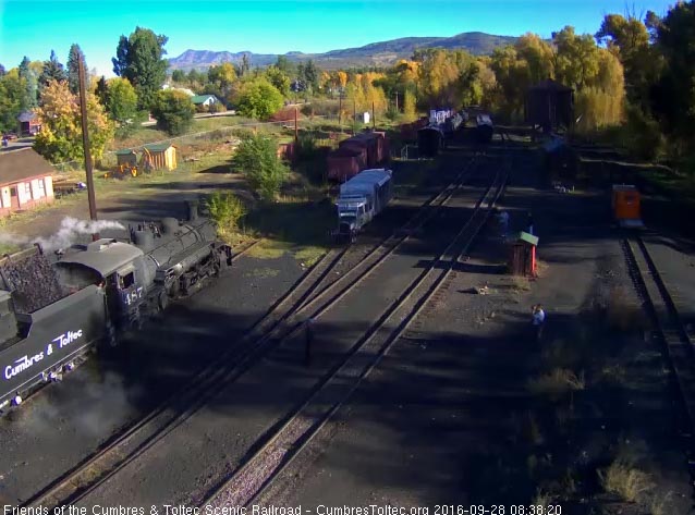

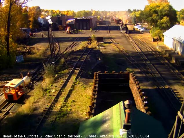

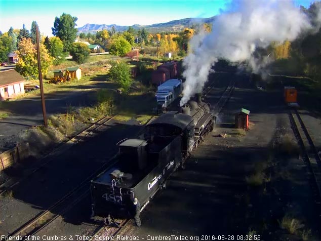

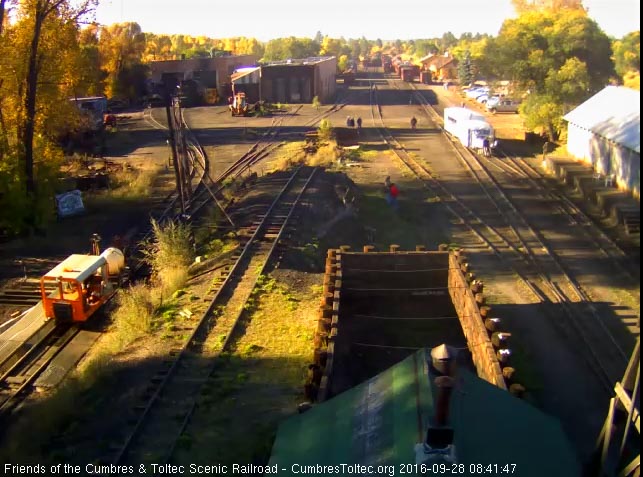

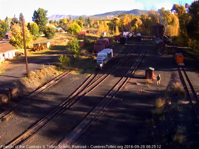

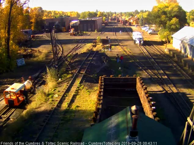

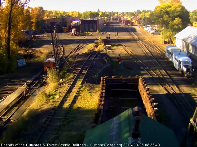

Morning activities including Goose 5 departure and preparations for today's 216: 487
9.28.16 487 is moving out to the pit to begin its day and we can see people gathering around Goose 5.jpg
9.28.16 487 is moving out to the pit to begin its day and we can see people gathering around Goose 5.jpg (116.7 KiB) Viewed 3663 times
9.28.16 487 has moved to the tank to take water.jpg (114.86 KiB) Viewed 3660 times
9.28.16 487 backs down the main toward the coal lead.jpg (100.32 KiB) Viewed 3654 times
9.28.16 487 pulls forward toward the coal dock.jpg (121.17 KiB) Viewed 3654 times
9.28.16 487 gets coal added to its bunker.jpg (104.41 KiB) Viewed 3654 times

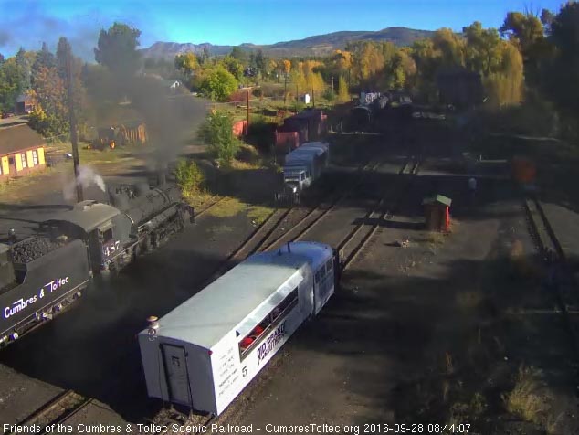

9.28.16 Goose 5 has now left the depot and is pulling up_.jpg (115.42 KiB) Viewed 3652 times
9.28.16 Goose 5 is by the wood shop.jpg (123.89 KiB) Viewed 3652 times
9.28.16 The sun glints off the white skin of Goose 5 as it backs to the main.jpg
9.28.16 The sun glints off the white skin of Goose 5 as it backs to the main.jpg (123.37 KiB) Viewed 3652 times
9.28.16 On the main, the pilot gets back on board after setting the switch.jpg
9.28.16 On the main, the pilot gets back on board after setting the switch.jpg (128.74 KiB) Viewed 3652 times
9.28.16 Goose 5 comes by the 487_.jpg (85.96 KiB) Viewed 3652 times

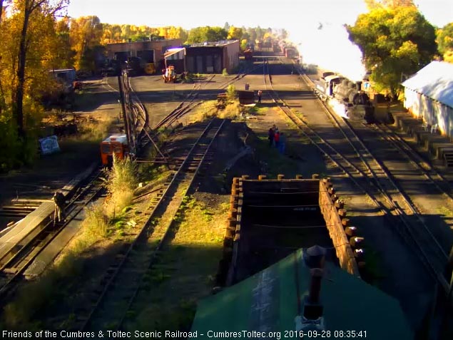

Morning activities continue:
9.28.16 Goose 5 is almost out of Chama on its way east to Antonito.jpg (108.37 KiB) Viewed 3652 times
9.28.16 487 waits for the road crew as the fire patrol speeder pases the pit.jpg
9.28.16 487 waits for the road crew as the fire patrol speeder pases the pit.jpg (129 KiB) Viewed 3652 times
9.28.16 487 has coupled to train 216 with the extra coach.jpg (89.88 KiB) Viewed 3643 times

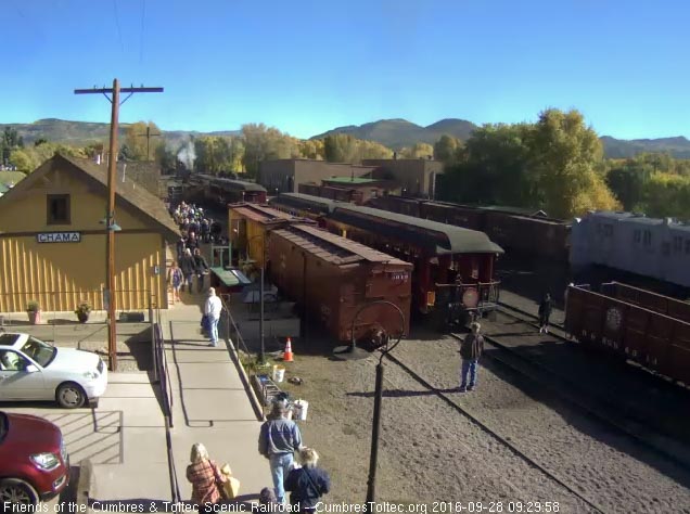

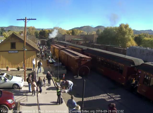

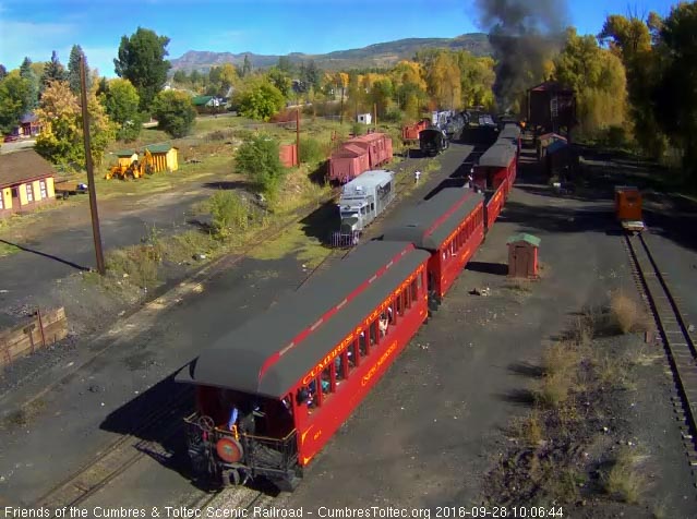

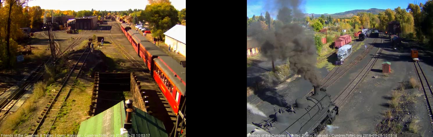

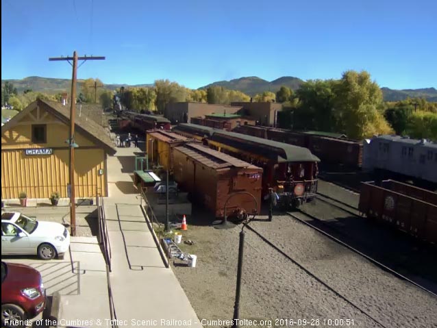

Departure of train 216: 487 and 8 cars
9.28.16 216 has now moved into loading position.jpg (98.09 KiB) Viewed 3642 times
9.28.16 The conductor has just given the hi ball.jpg (97.05 KiB) Viewed 3623 times
9.28.16 The conductor is now on the platform of the New Mexico.jpg (97.92 KiB) Viewed 3623 times

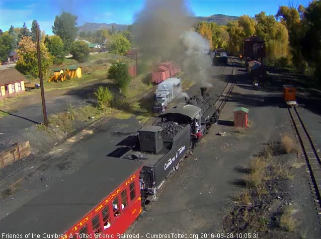

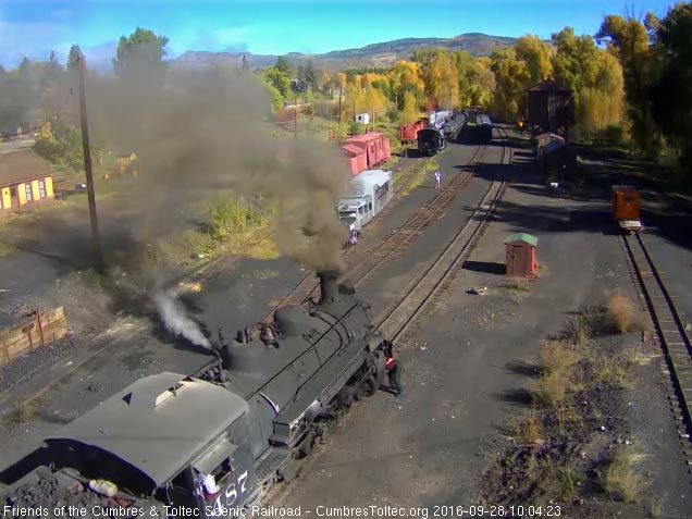

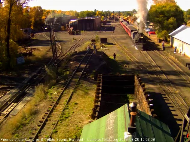

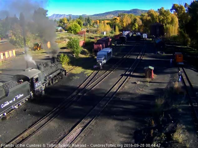

9.28.16 The 487 comes by the wood shop, note the steam by the engineer side cylinder.jpg
9.28.16 The 487 comes by the wood shop, note the steam by the engineer side cylinder.jpg (126.35 KiB) Viewed 3623 times

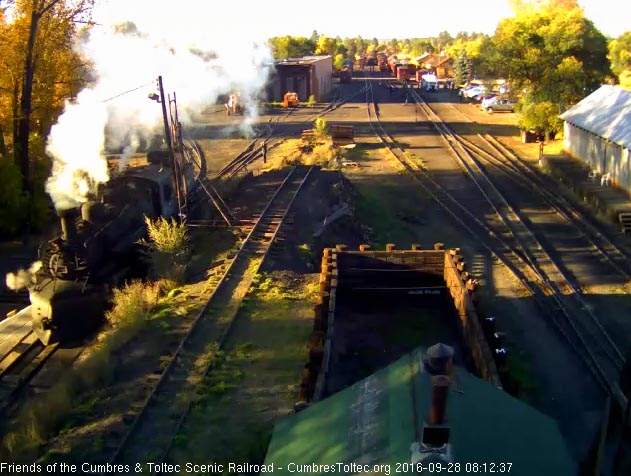

As the 487 passed the tipple he slows to a stop.
The fireman gets off the engine and walks up to the engineer's side cylinder.
9.28.16 The fireman is checking something on the front of the cylinder.jpg (103.74 KiB) Viewed 3623 times
He looks at the front of the cylinder and is heard banging on something. He has the engineer move the train forward several times and notes the steam escaping. He goes under the 487 several times until he seems satisfied.
9.28.16 Satisified with whatever he die, he climbs back in the cab as the train begins moving again.jpg
9.28.16 Satisified with whatever he die, he climbs back in the cab as the train begins moving again.jpg (101.44 KiB) Viewed 3623 times
9.28.16 Still moving very slowly, the New Mexico passes the tipple.jpg (112.2 KiB) Viewed 3623 times
9.28.16 The train is now moving out of Chama yard.jpg (109.59 KiB) Viewed 3623 times

Sharon Evans wrote:Departure of train 216: 487 and 8 cars
Fireman is Tracy and he is probably checking the cylinder cock on the engineer's side.
Cylinder cock allows condensate to be removed from the cylinder before the condensate can damage the cylinder or piston. When open It also greatly reduces the amount of power that can be obtained from that cylinder.
Typically cylinder cocks are opened when the train is stopped and then closed once the engine has started moving. There is only one lever which controls the cylinder cocks on both sides of the engine and sometimes it gets out of adjustment and only one side will close.

Unread postby Sharon Evans » Wed Sep 28, 2016 12:12 pm
Is that one lever for both front and rear cocks or does each have a separate lever.

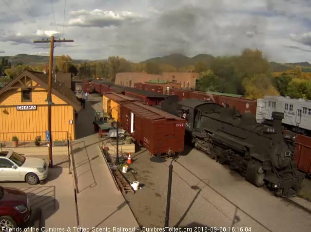

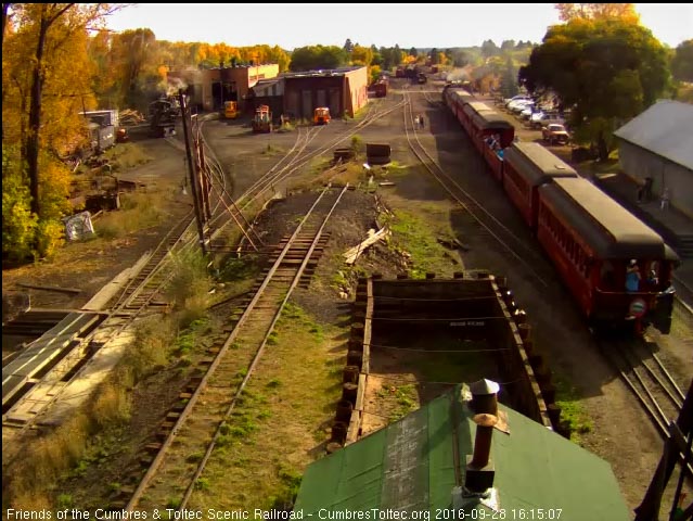

Arrival of train 215: 484 and 8 cars
9.28.16 215 is at Cumbres.jpg (111.76 KiB) Viewed 3558 times
9.28.16 484 brings an 8 car 215 into Chama.jpg (116.42 KiB) Viewed 3539 times
As the 215 passes the tipple we can see a number of riders in the open gon.
9.28.16 Colorado has several passengers enjoying the end of the trip.jpg (128.46 KiB) Viewed 3539 times
9.28.16 484 comes by the depot.jpg (87.82 KiB) Viewed 3539 times
9.28.16 The extra coach has a number of riders.jpg (95.22 KiB) Viewed 3539 times

Unread postby Pete Dahlberg » Wed Sep 28, 2016 2:41 pm
Sharon Evans wrote:Is that one lever for both front and rear cocks or does each have a separate lever.
1 lever opens cylinder cocks on both sides and front and rear
Pete Dahlberg
Posts: 479
Location: Arlington TX
Re: 9/28/16 Another busy morning
Unread postby Sharon Evans » Wed Sep 28, 2016 2:51 pm
Thanks

Unread postby Larry Sullivan » Thu Sep 29, 2016 4:41 am
Here's today's video -
487 leads an 8 car consist as 216 heads out. Briefly stopping by the tipple to check/fix something with the cylinders - nice explanation above by Pete Dahlberg explaining what they likely were doing. Thanks Pete, always appreciate the information!
About 30 minutes after 216 left, 489 went to the water tank and got a load of coal. 463 was getting ashes cleaned as well. 489 then went and sat on the South yard lead until about 2pm when they went back to the shop. My GUESS, and only a guess - 487 had a further problem up the line and 489 was called to stand by just in case.
