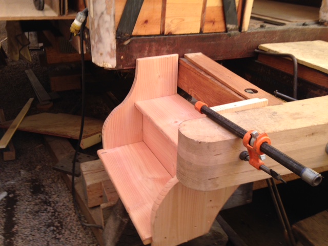

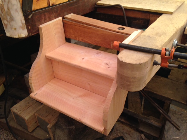

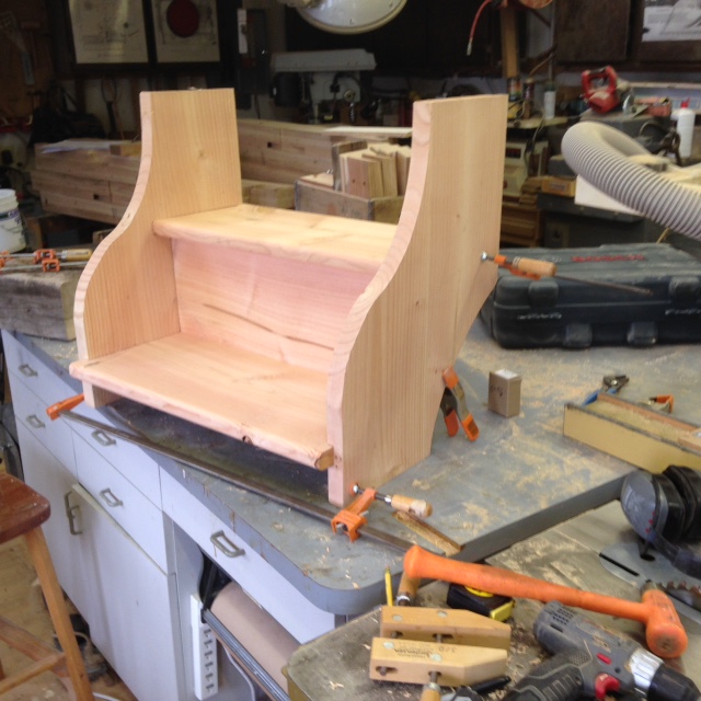

Assembling a prototype design from reference information gathered. The prototype will be fitted a number of times before it can be considered correct.

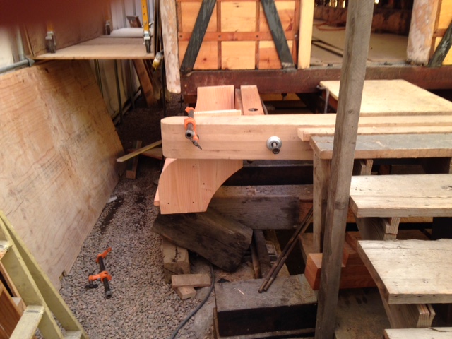

Fitting the prototype stair set on the car. Looking from the rear you can check lower step protrusion from side of car.
Looking at the left side of the stair set note that it is low on the end sill. It is determined that an angle bracket will be needed. The angle will be mounted to the underside of the end sill and attached to the stair riser.

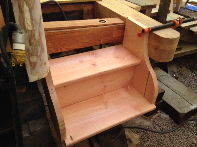

From the front you can see the relationship of the platform to the top toe board. The platform extends over the top of board. You will also notice the platform pitch is to the rear.
You can see the right riser is flush to the top of the buffer beam allowing direct wood to wood attachment.

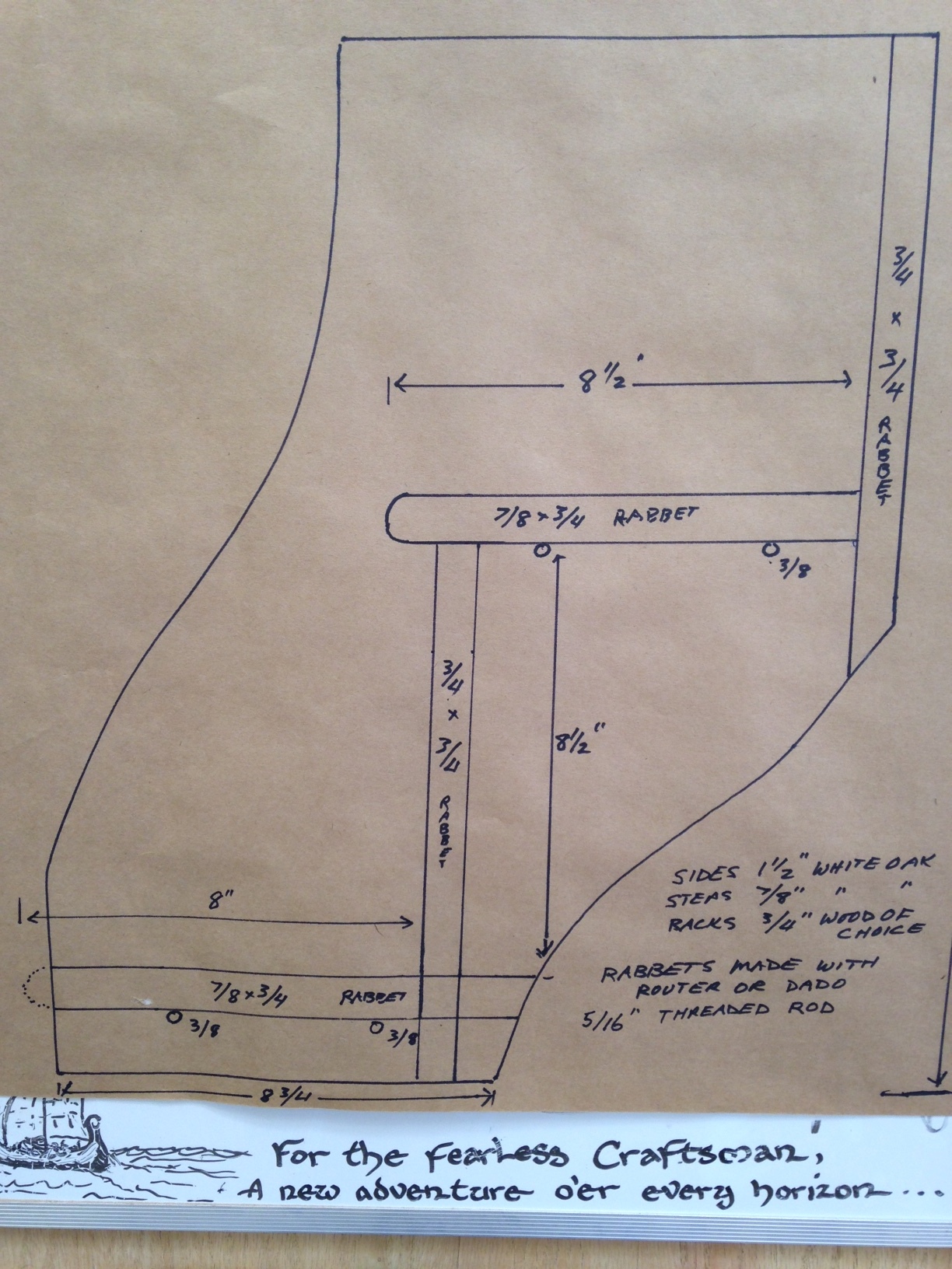

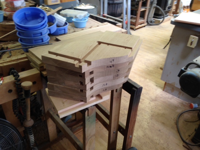

After completion of all adjustments to the prototype it’s necessary to complete a drawing of the actual measurements of all the pieces.
Each piece of wood is cut to correct size. Like pieces are cut at the same time, rabbets on the rails are made with a dado. Lumber for the rails and steps is white oak, the toe boards are of fir. Support rods are cut to length from 5/16” steel rod and threaded.
