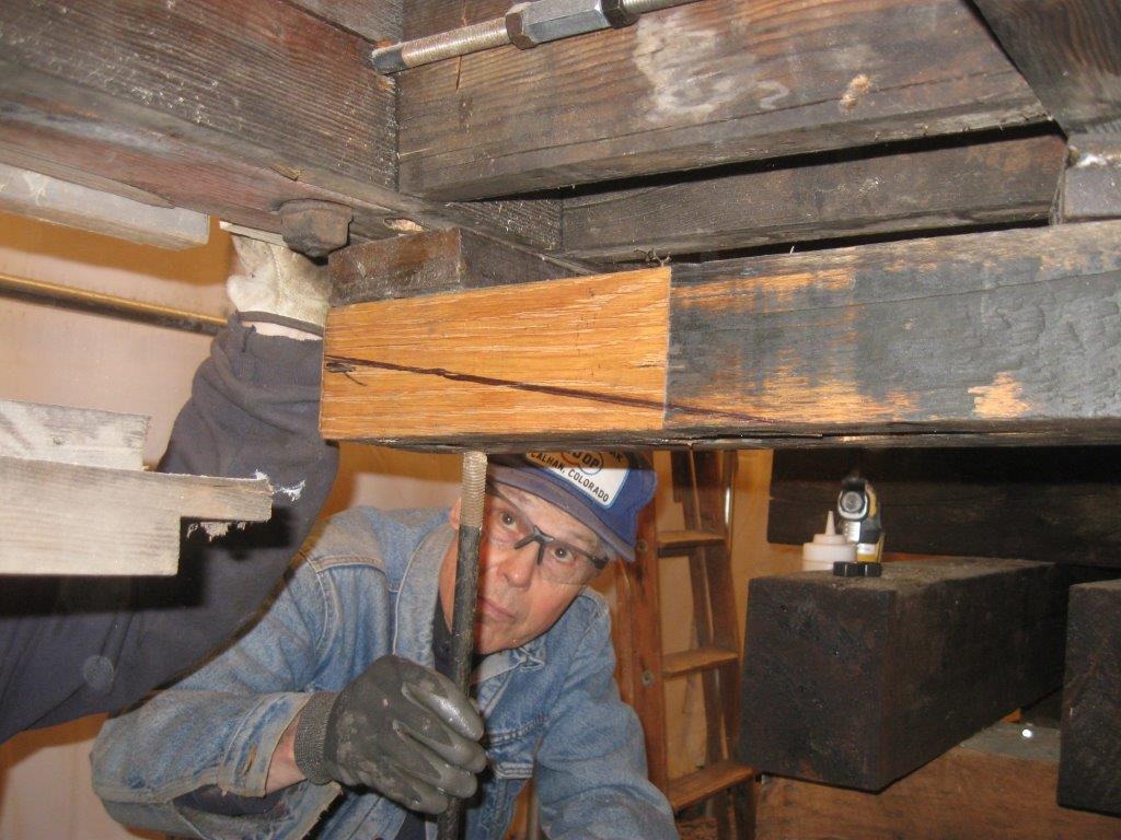

There are many challenges in the restoration of a car when you have little and sometime no reference to the details of construction in the year 1889. We had the original needle beams which were removed during the car tear down but their ends had deteriorated. Craig McMullen was successful in remaking the ends for both beams from white oak. To enhance the structural abilities of the beams a 1-1/2” x 3/8” steel channel was routed into the top of each beam. The beam channel rests directly against the steel angles of the center sills when assembled. The intermediate and outside sills have a 1-3/8” steel spacer to make up the difference between the wood sills and the beam. The beam is secured to each of the interior sills by a 3/4” Grade 8 bolt. Fortunately, we were able to find an actual resource to compare with in our backyard, that being a sister car, last numbered 0250 resting on cribbing at the Colorado Railroad Museum (CRRM). It is the only car of the same purchased lot by D&RG that was not salvaged, thus a reference with physical substance as it still contains all of the undercar intricacies. The first picture is an enlargement from the side view of car 466, the fifth car in the manufacturing series, taken by Pullman as a manufacturers’ photograph prior to shipment from the Detroit factory. We have used this photo enlargement to confirm the authenticity of needle beam construction on car 0250. During our visit to the CRRM the second photo is of a needle beam taken from under that car. From details obtained, drawings were made for manufacture of both standards and queen posts, images 3 thru 9. With a great deal of help from Marshall Smith who, from his shop in San Marcos, Texas, used the drawings to fabricated duplicates of both the standards and queen posts. The remaining photos show the process of assembly with the standards supporting the needle beam truss rod and the fitting of queen posts to the beam. Compare the two pictures of the original and the restored; see if you can tell the difference? Thanks for the fine work done by Marshall Smith, Craig McMullen and the COS restoration team in the assembly of the car needle beams. Photos provided by Tom Simco.

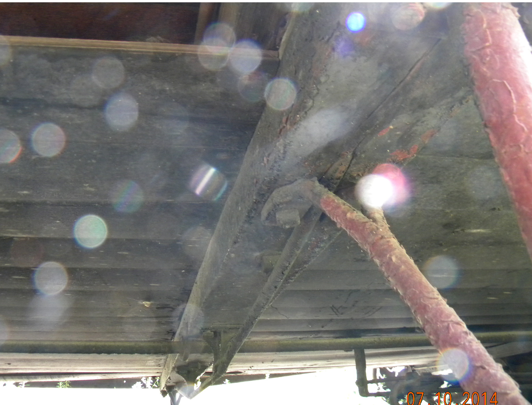

This picture is taken from a side view of car 0250, showing the actual under side of the needle beam, its truss rod standards and queen posts. Measurements were taken from these standards and queen posts to replicate both for car 0252/470.

Duncan Burdick is aligning the bolt holes for the sill, spacer and needle beam. You can see the splice made to the end of the needle beam for repair the angled mark on the side was to align the drill bit for drilling out for the truss rod hole.
