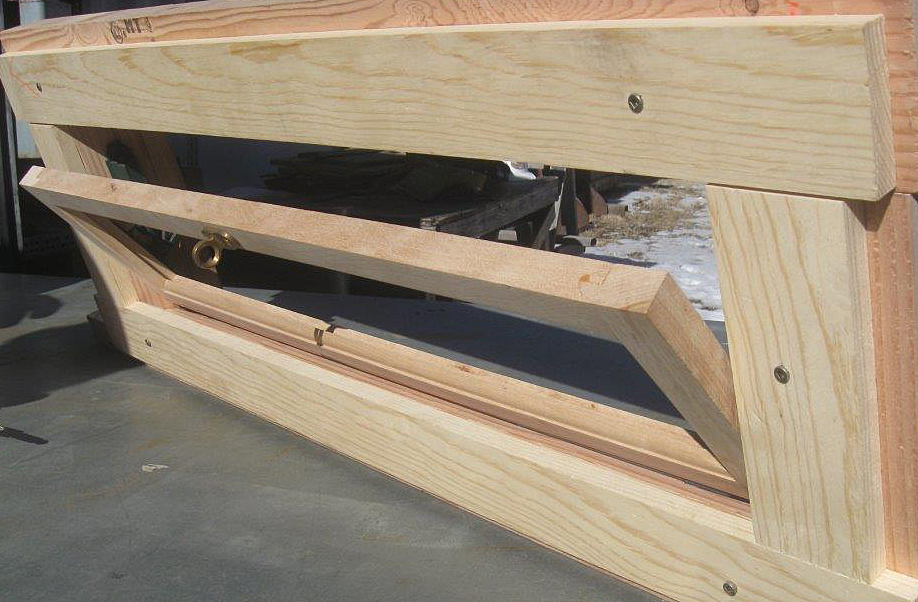

This shows the window in the open position as viewed from the inside of the car

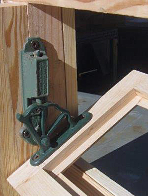

This view shows the mechanical operator that holds the window in various positions
Mech Opener Latch.jpg (131.82 KiB) Viewed 12255 times

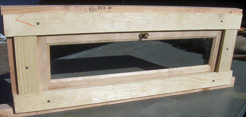

This view show the window in an open position from the outside of the car
Open From Outside.jpg (292.53 KiB) Viewed 12255 times

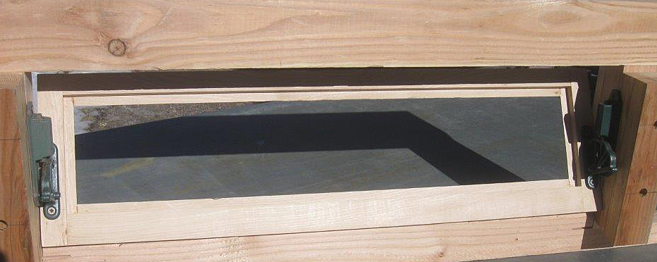

This view represents what you would see from the inside of the car
View from inside.jpg (361.41 KiB) Viewed 12255 times
Restoration of Tourist Sleeper Car 0252/470 - Clerestory: To have an understanding as to the assembly of the clerestory windows it was necessary that a prototype be assembled. The window sits between the screen block on the exterior and a mechanical step latch mounted on each side of the window to the screen block. The latch mechanism has a pin that rides on the arm attached to the window. The pivot point for the window is critical as the window pulls to the inside; it must clear the upper frame to open as well the base pivoting outward must clear the sill. The sill is a rolled seat to a high point on the inside that matches the window preventing water entry. The mechanical latches are original to the car; all are in perfect operating order as well the pull eyes for opening the clerestory windows. Thanks to Craig McMullen for assembling the prototype and to Tom Simco for the pictures.
