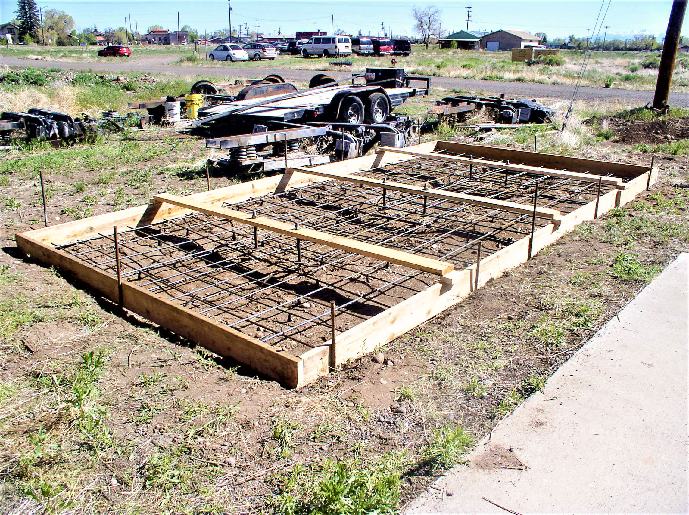

The pad looks ready for the pour

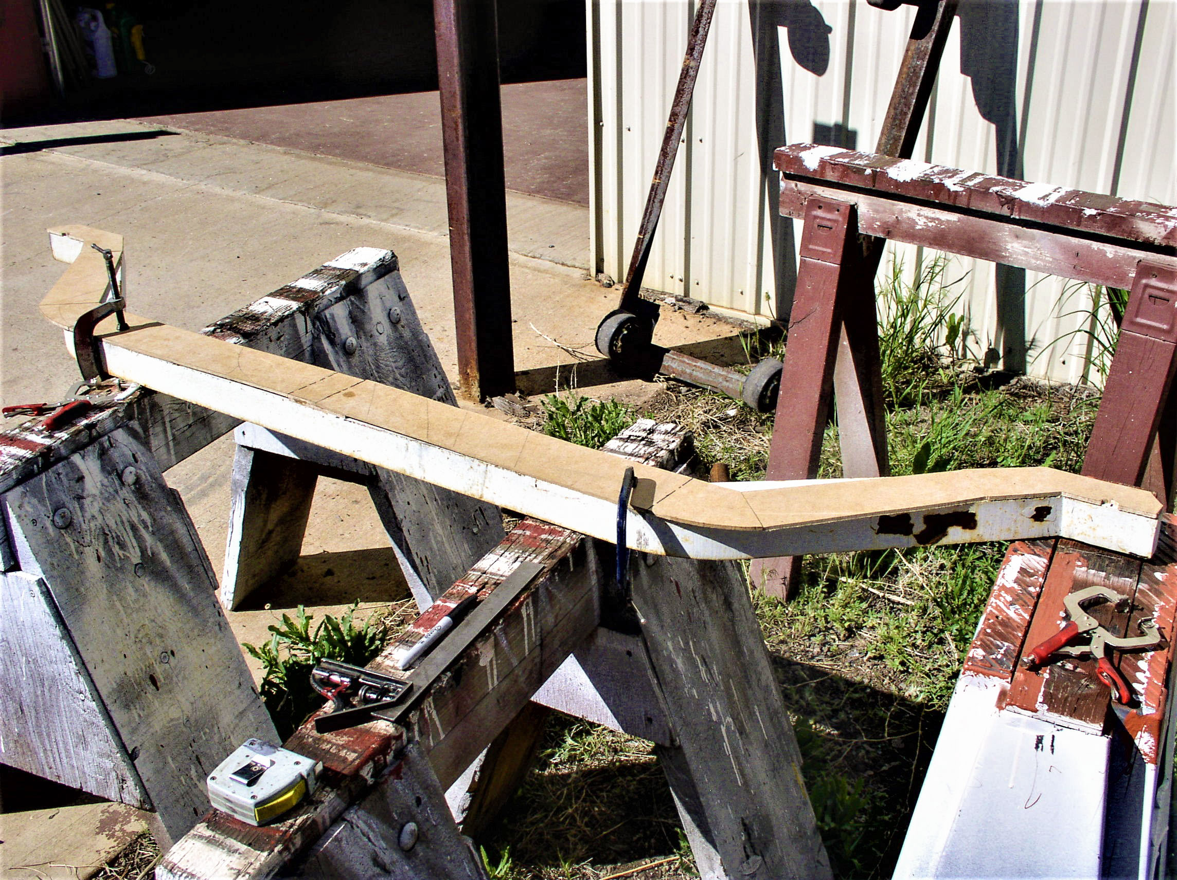

Looks like they have glied a strip of wood onto this beam

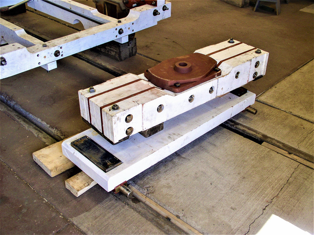

Another passenger car truck is taking shape

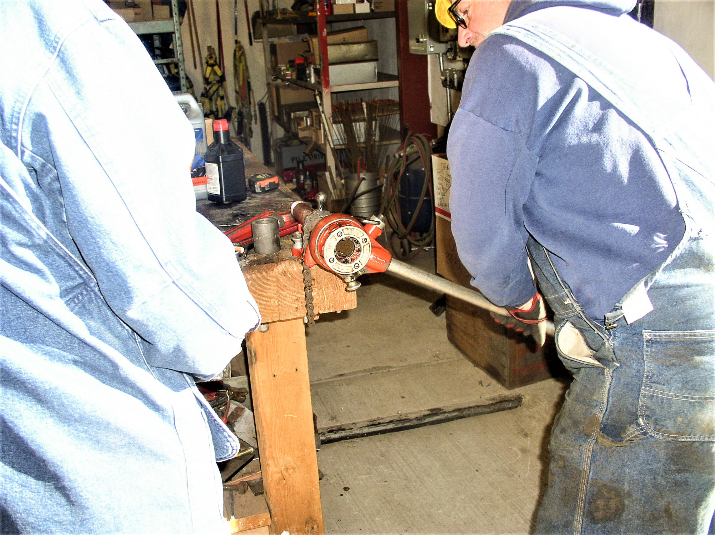

A length of pipe is getting threads cut into it

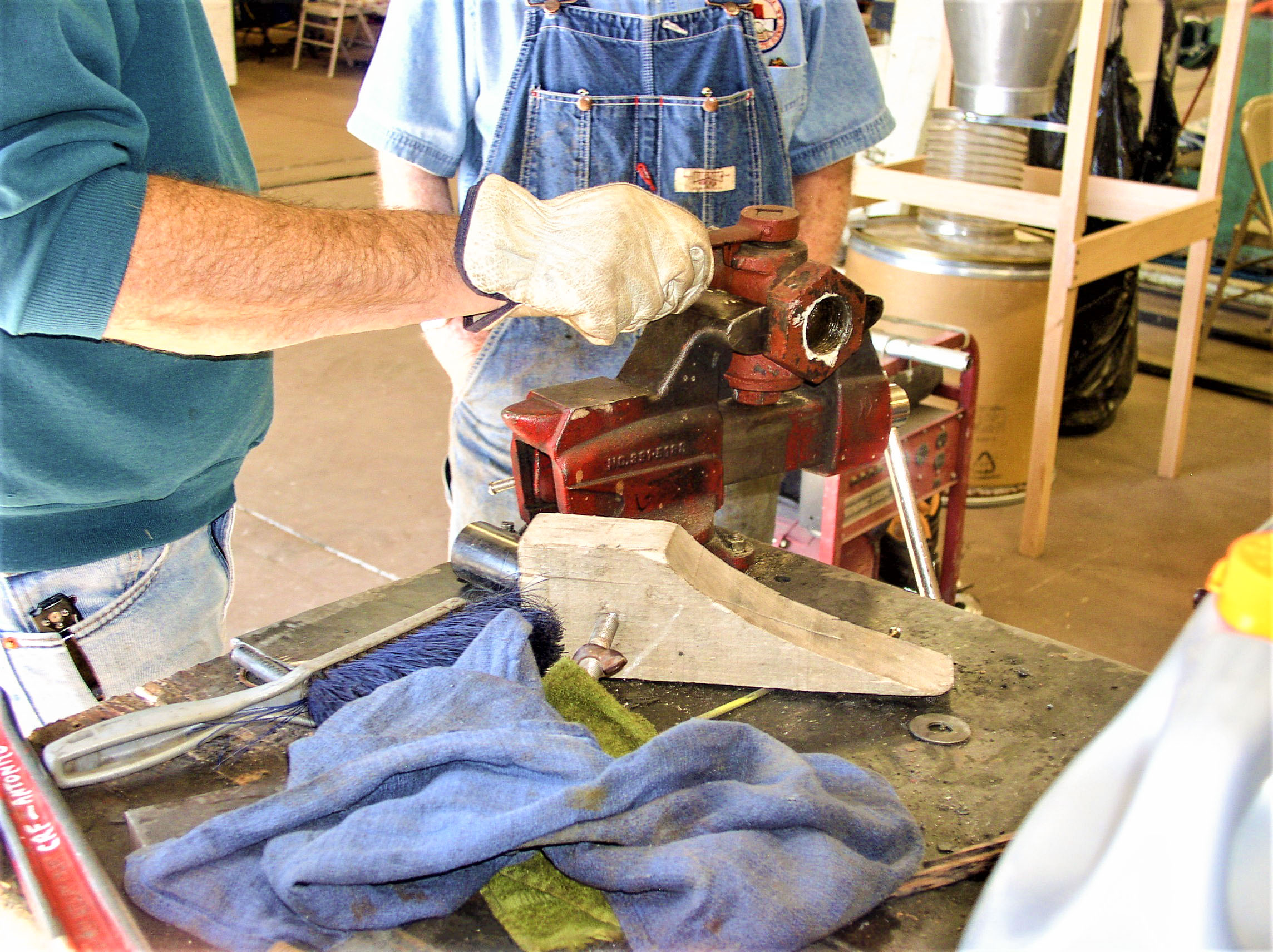

Working of the valve maybe for the brakes of a car

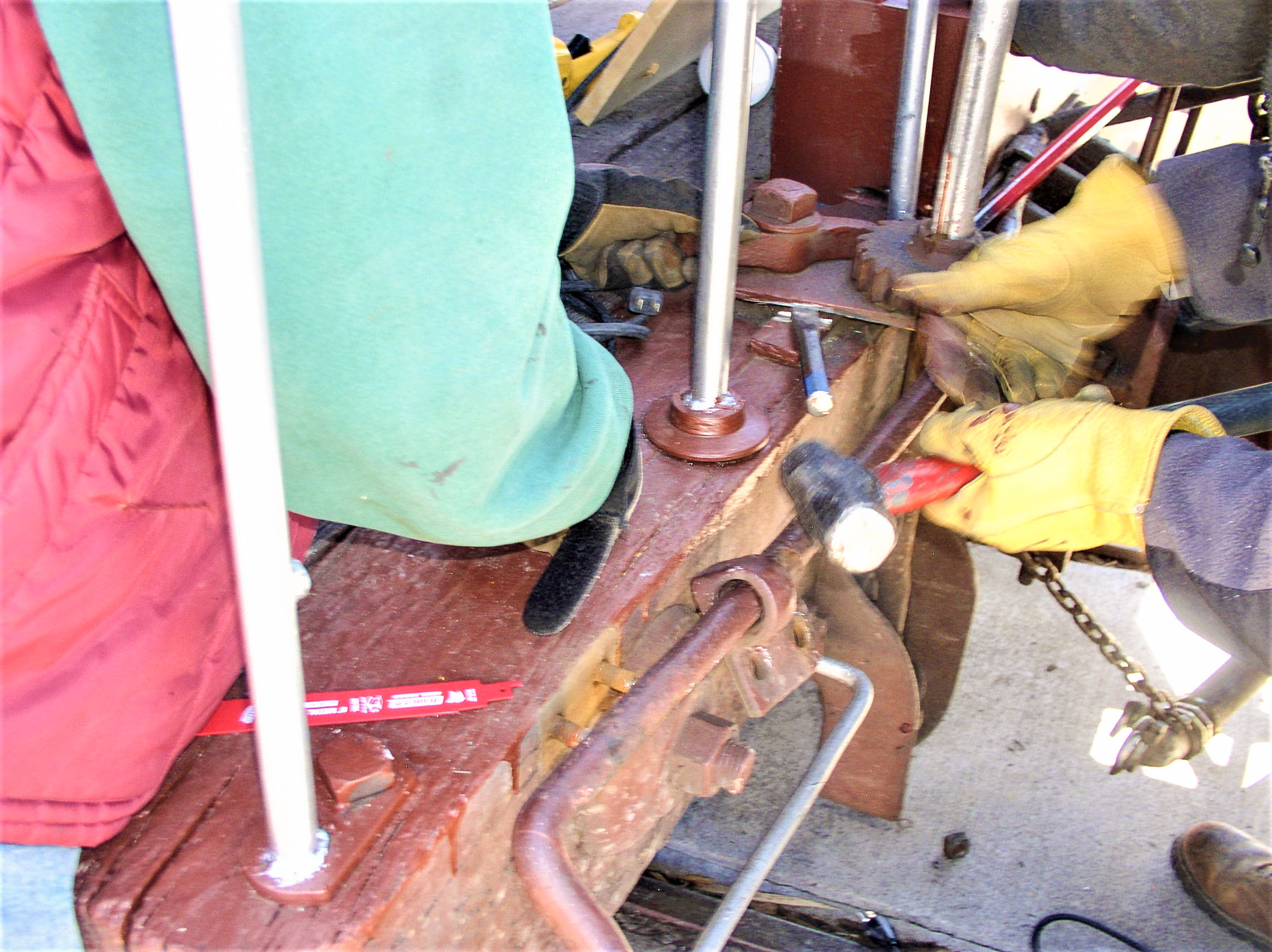

Looks like they are working on the hand brake for the caboose

2nd picture down - the masonite is being used as a template for a reworking of the equalizer bars for the 470 trucks.

The 5th picture down is the isolation valve for the air brake system on flatcar 6214. After upgrading the air lines from schedule 40 to schedule 80, a system check revealed the only major leak was this valve. We were struggling to take it apart (for the first time in 90 years?) so we could repair the leak.
We were not successful and will have to complete this repair in work week G.
