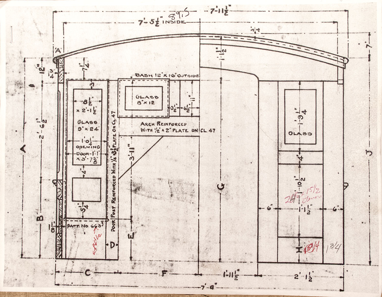

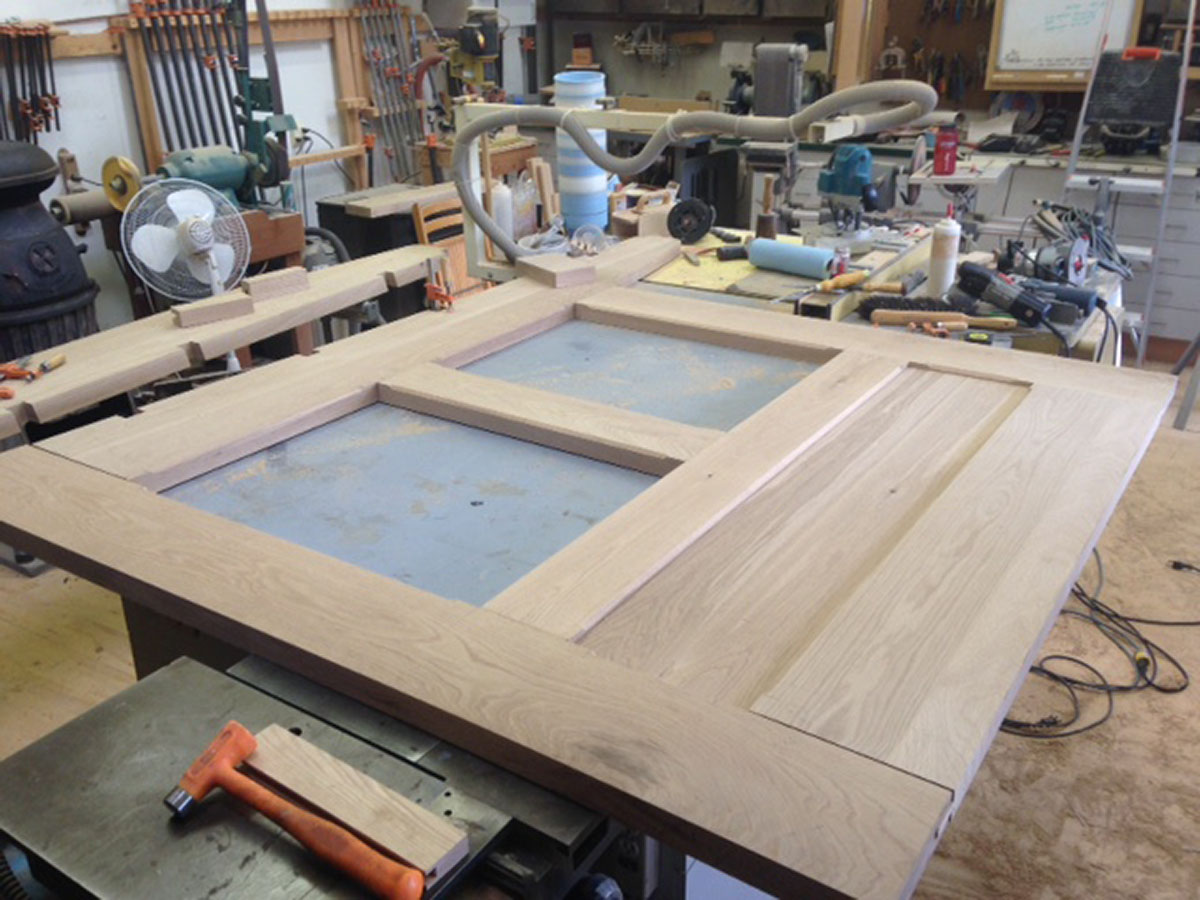

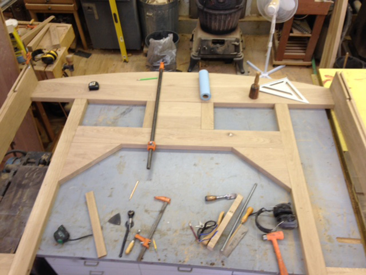

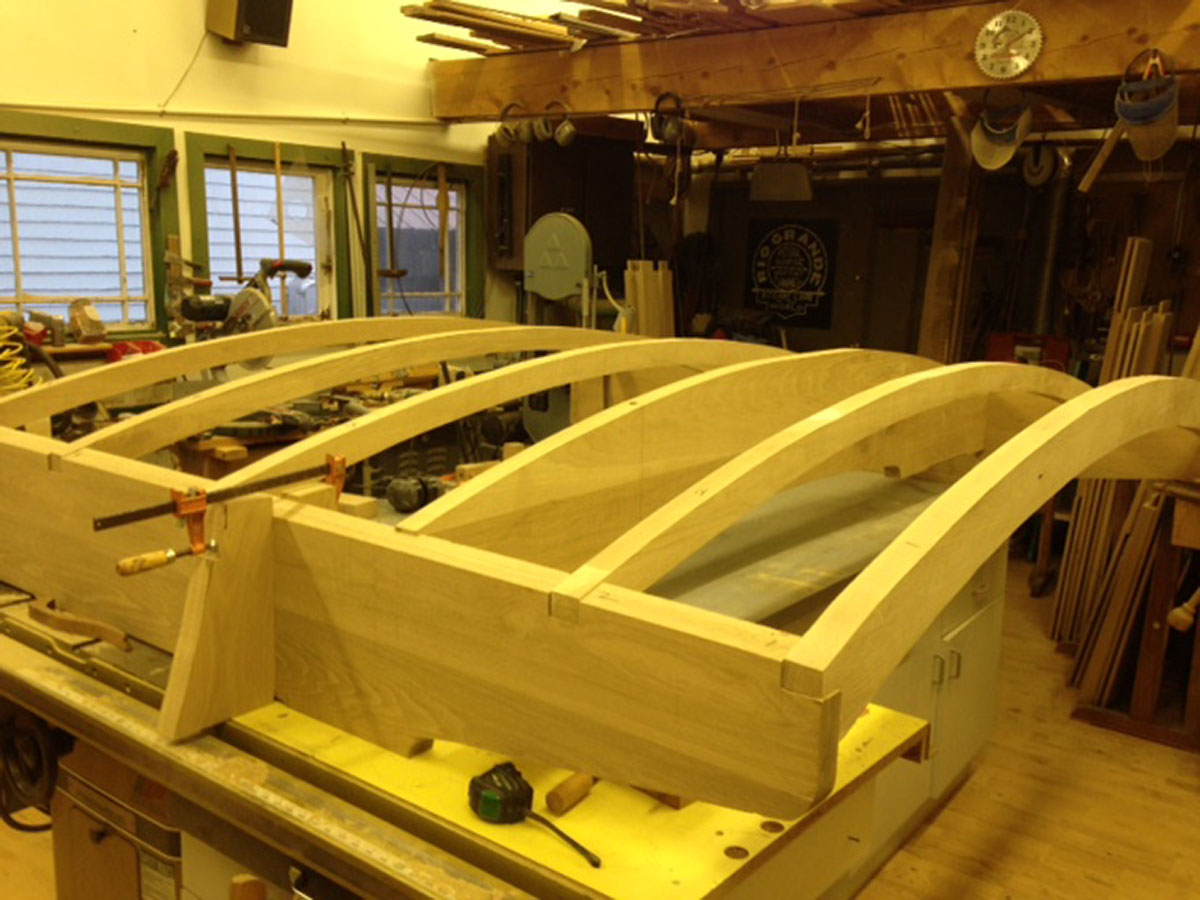

Parts for D&RGW 168 were fashioned in Craig McMullen's Colorado Springs workshop and transported to Antonito:
Craig McMullen's (and others) craftsmanship (look at that joinery!) is amazing!

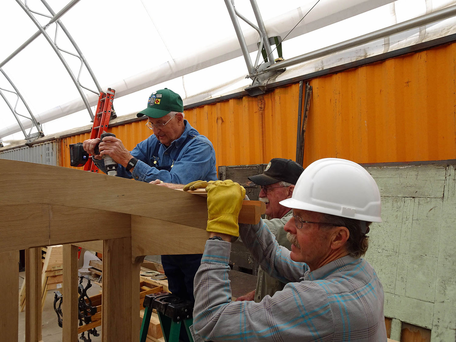

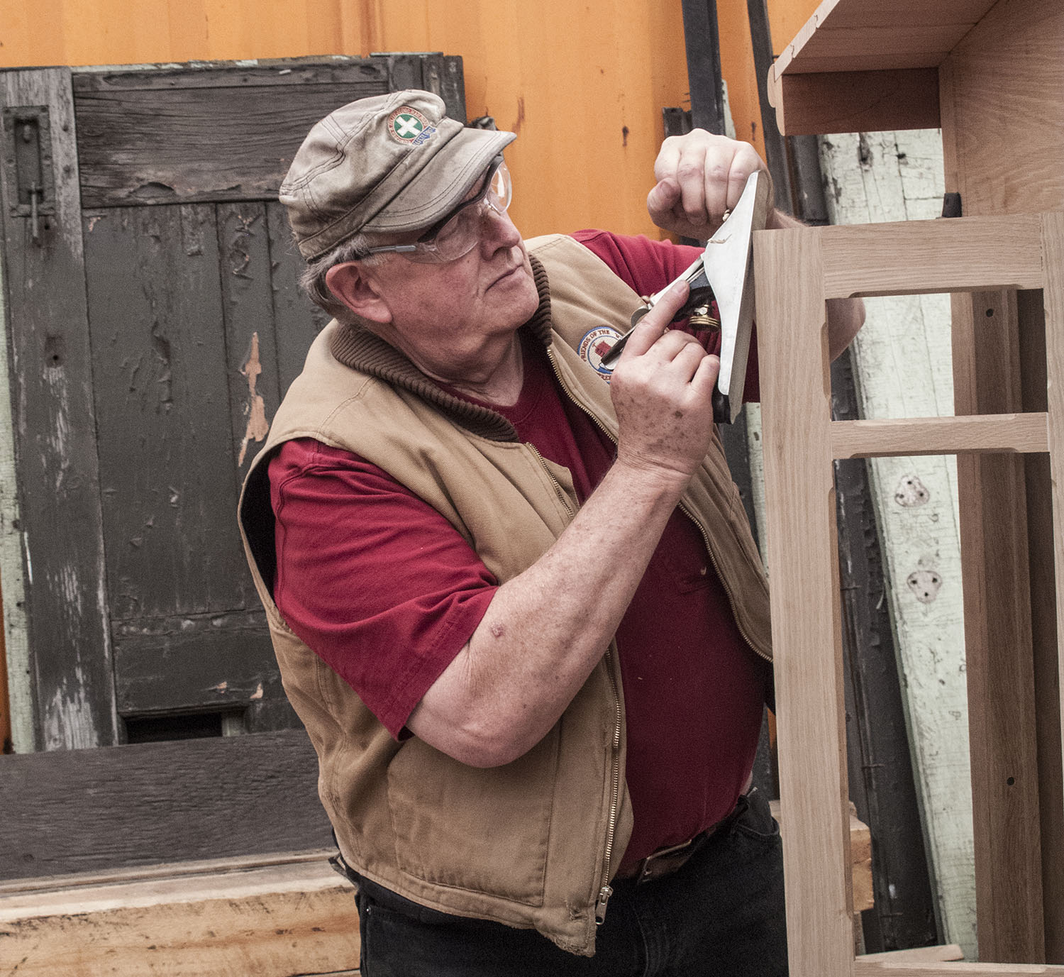

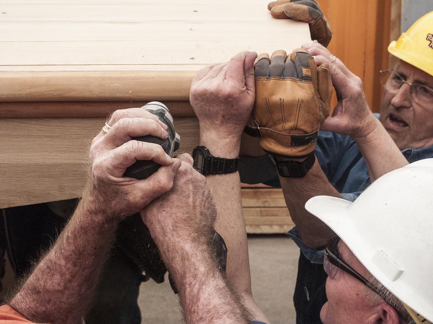

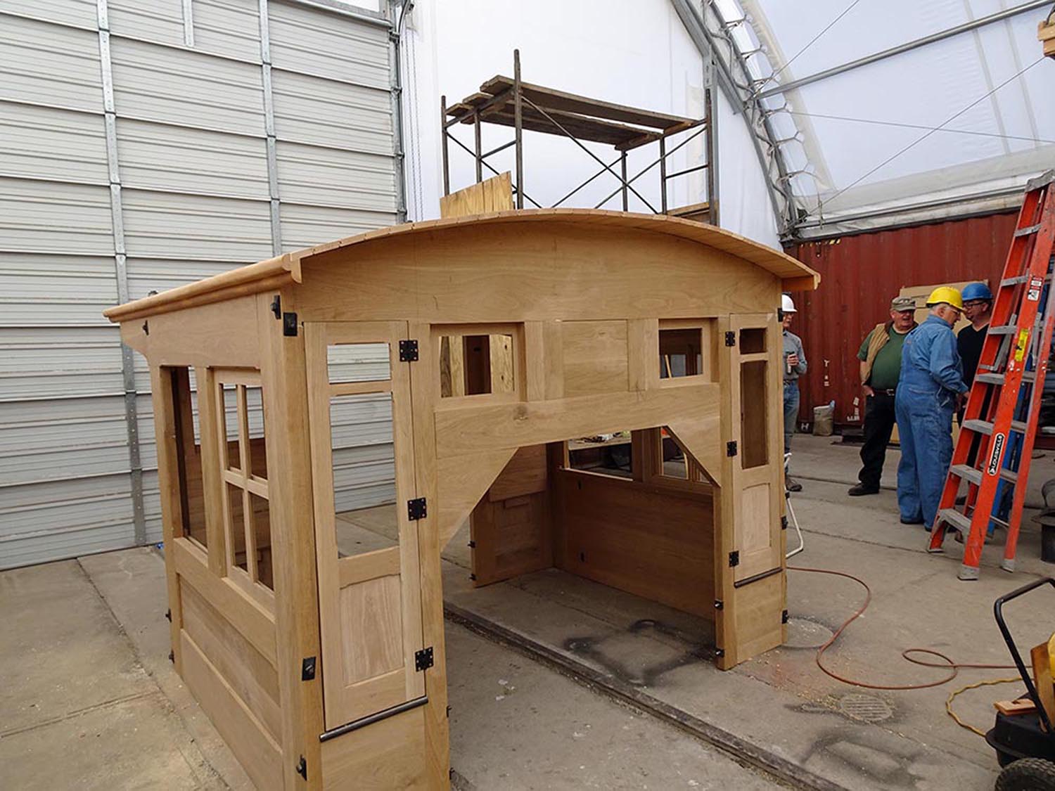

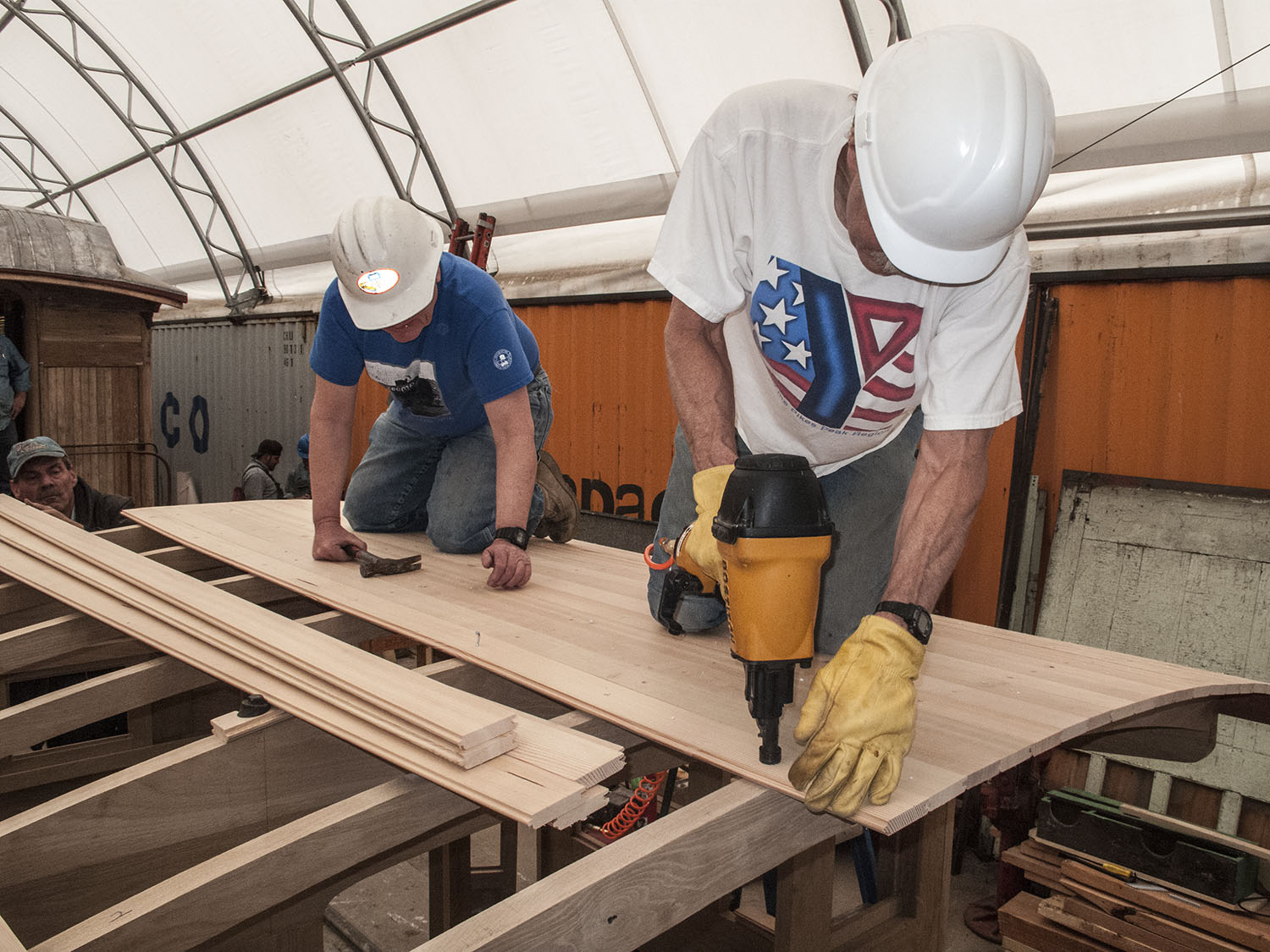

In the Quonset shop in Antonito (with blustering wind outside) the crew assembled the cab and placed the tongue-and-groove roof in place.

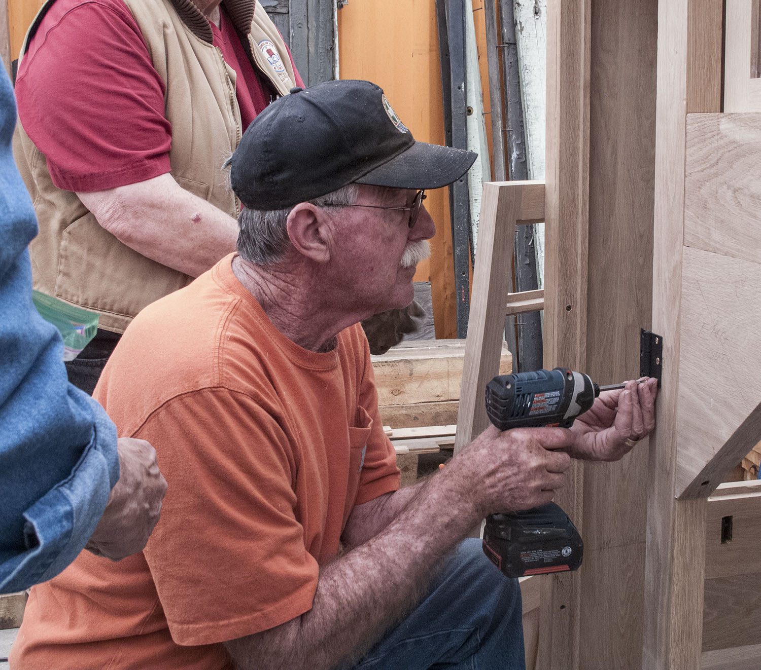

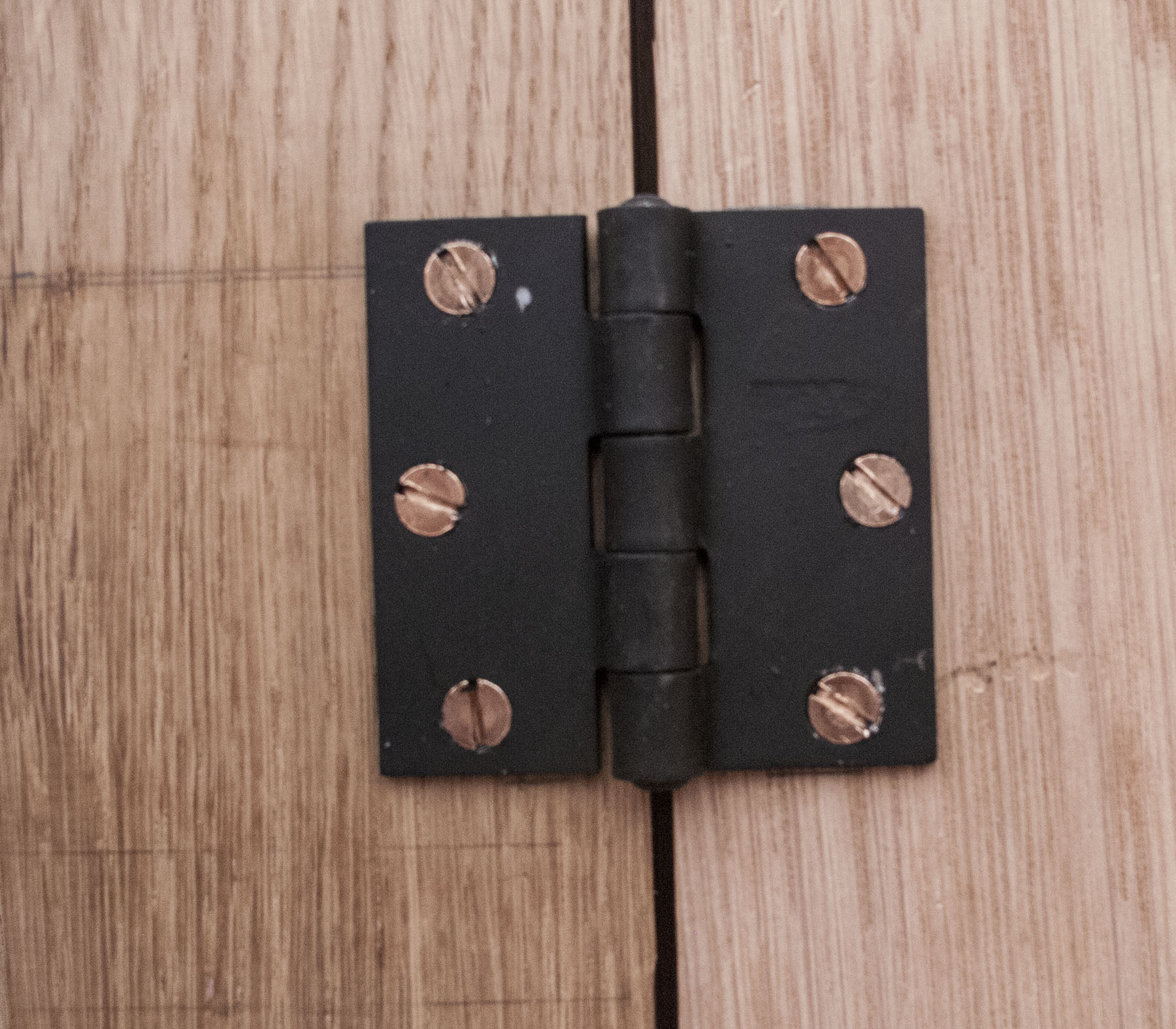

Front cab doors were installed and hinges added
I was particularly impressed with the degree of historic accuracy (but why should I be surprised?) in using brass, slot-head screws on the hinges and not your typical hardware store hex-phillips head screws. As John Engs said, "Well, it has to be correct."
Note: I stand corrected. Craig McMullen tells me that these are "silicon bronze screws not brass," boat builder's hardware, which would make them a little less "historic" for 168. So OK, but they are still slot head and not Phillips or a 16d box nail, bent over, something I would probably do. cj
Remember the old saying, Many Hands Make Light Work? It's true!
By about 2pm, assembly of 168's cab was just about complete.

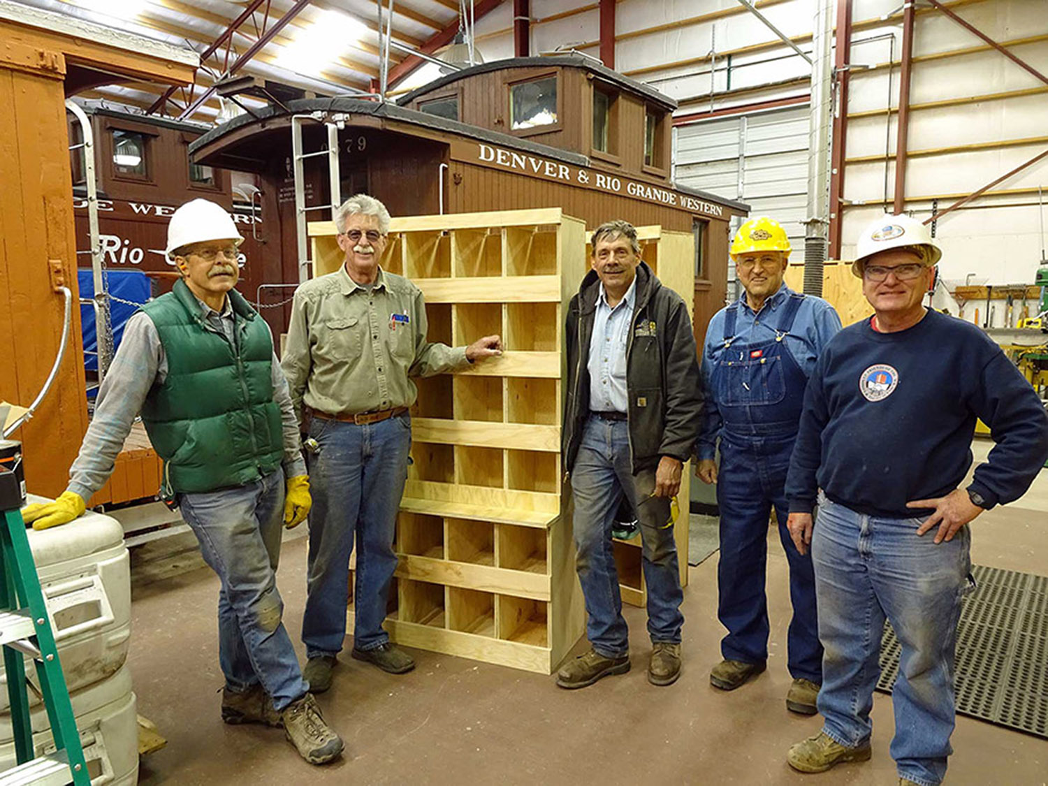

The crew then moved over to the CRF for construction of the new nut and bolt shelves:
Special Session 2 Crew: L-->R: Bill Stamm, Dean Myers, Craig McMullen, John Engs, Lion Beier, Don Atkinson

As a carriage and Wagon Builder down here in Australia, I have to commend the great job you fella's are doing and can appreciate the work put in.
But, just a comment, not criticism, do you fella's not have the practice of lining up the screw slots?
Looks like someones power driver might have jumped the slot on the bottom right hand screw! easy to do with brass screws.
How will the cab be finished off, paint or varnish??
