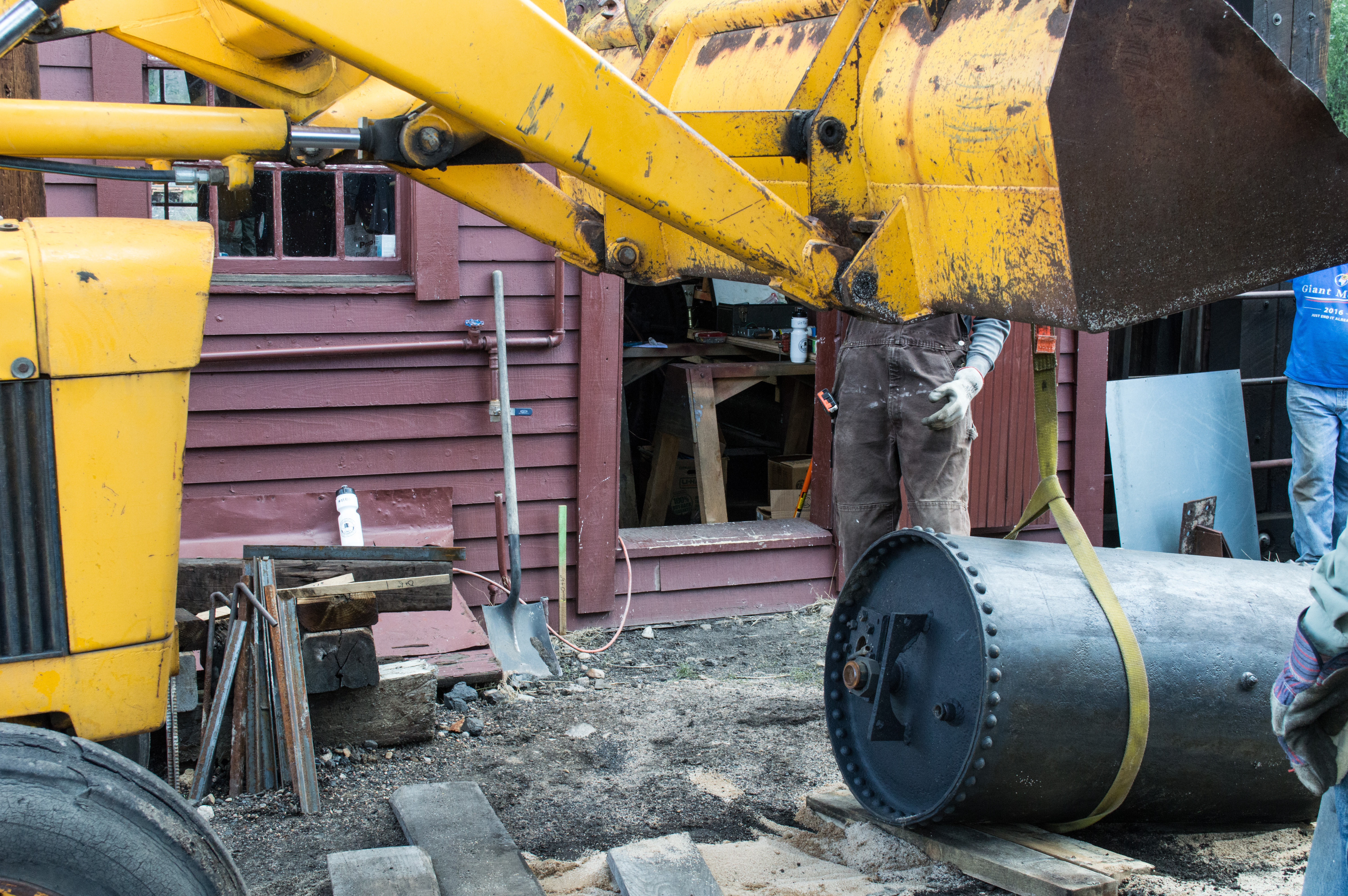

Well no rain today to spoil the activities going on. Sunny with cloudy periods and temperatures upper 70's for the most part. The most interesting thing going on today was the placing of the air tank into the sand house. The Friends have been working most of the summer sessions repairing the sand house getting it ready to provide sand to the locomotives on a daily basis. Next step, which should happen tomorrow is raising the storage tank for the sand onto the tower from which gravity will allow locomotive crews to fill the sand dome. Keep in mind that this air tank weighs around 800 lbs.

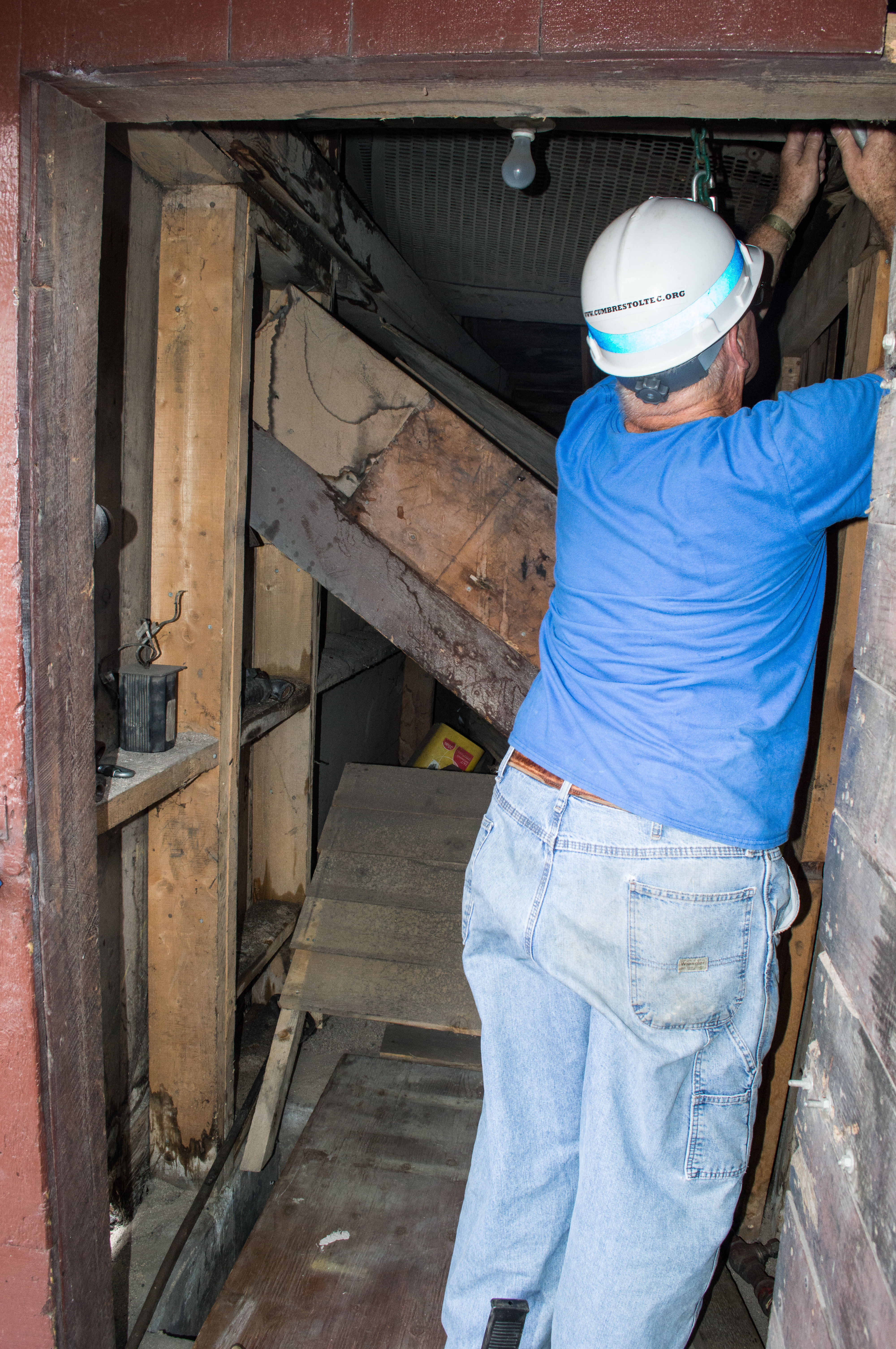

7-26-17 Barry Morris installs the comealong support for moving the air tank into place.jpg
Barry Morris, part of the crew working on the sand house, installs the chains to support the come-along that will be used to raise the tank

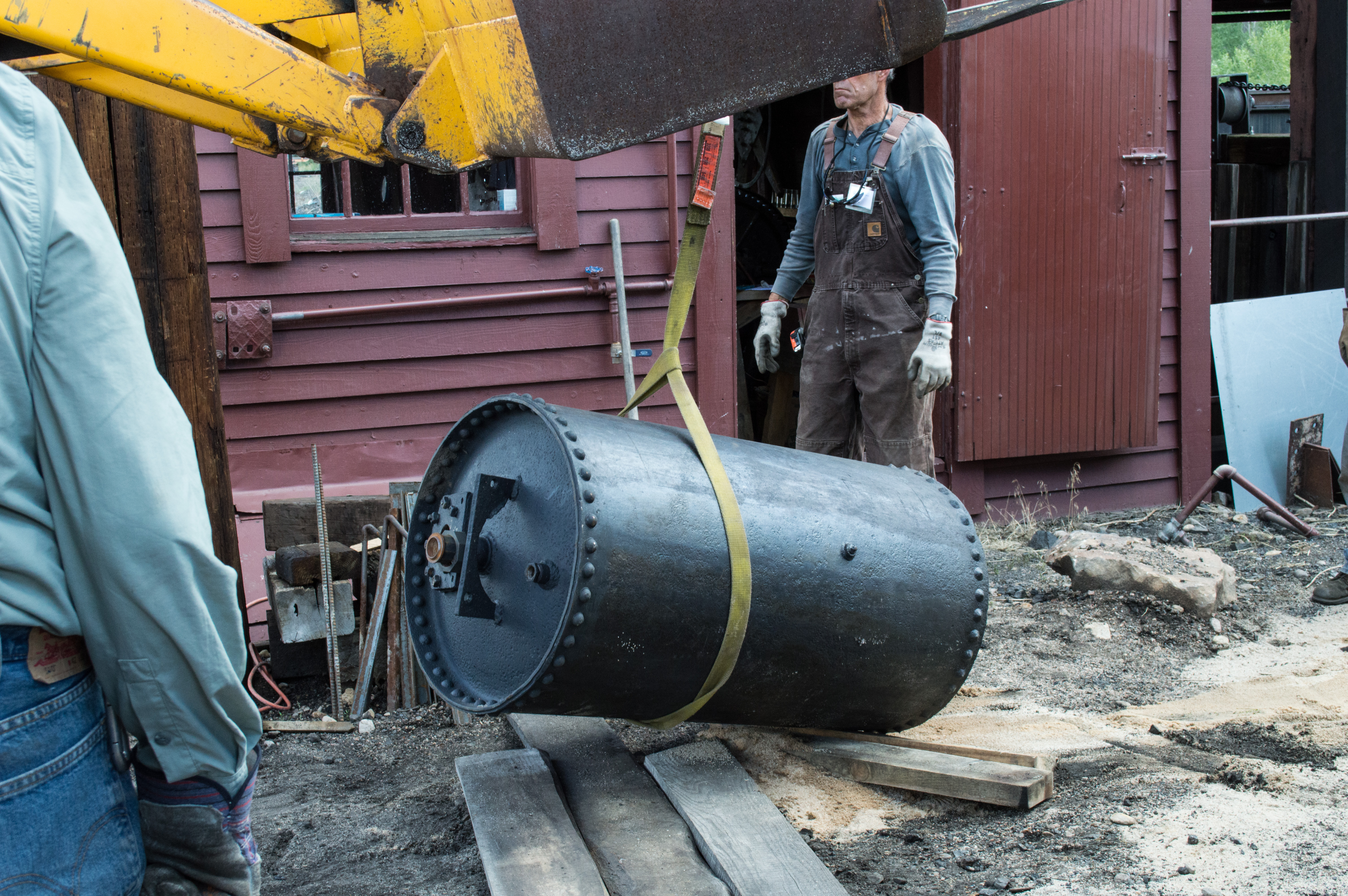

7-26-17 Using a fork lift, they move the 800 lb air tank to the boards they will roll it on.jpg
Using a bucket loader with folk attachments and a sling, then get to moving the tank toward the board that will be used to roll it to the sand house

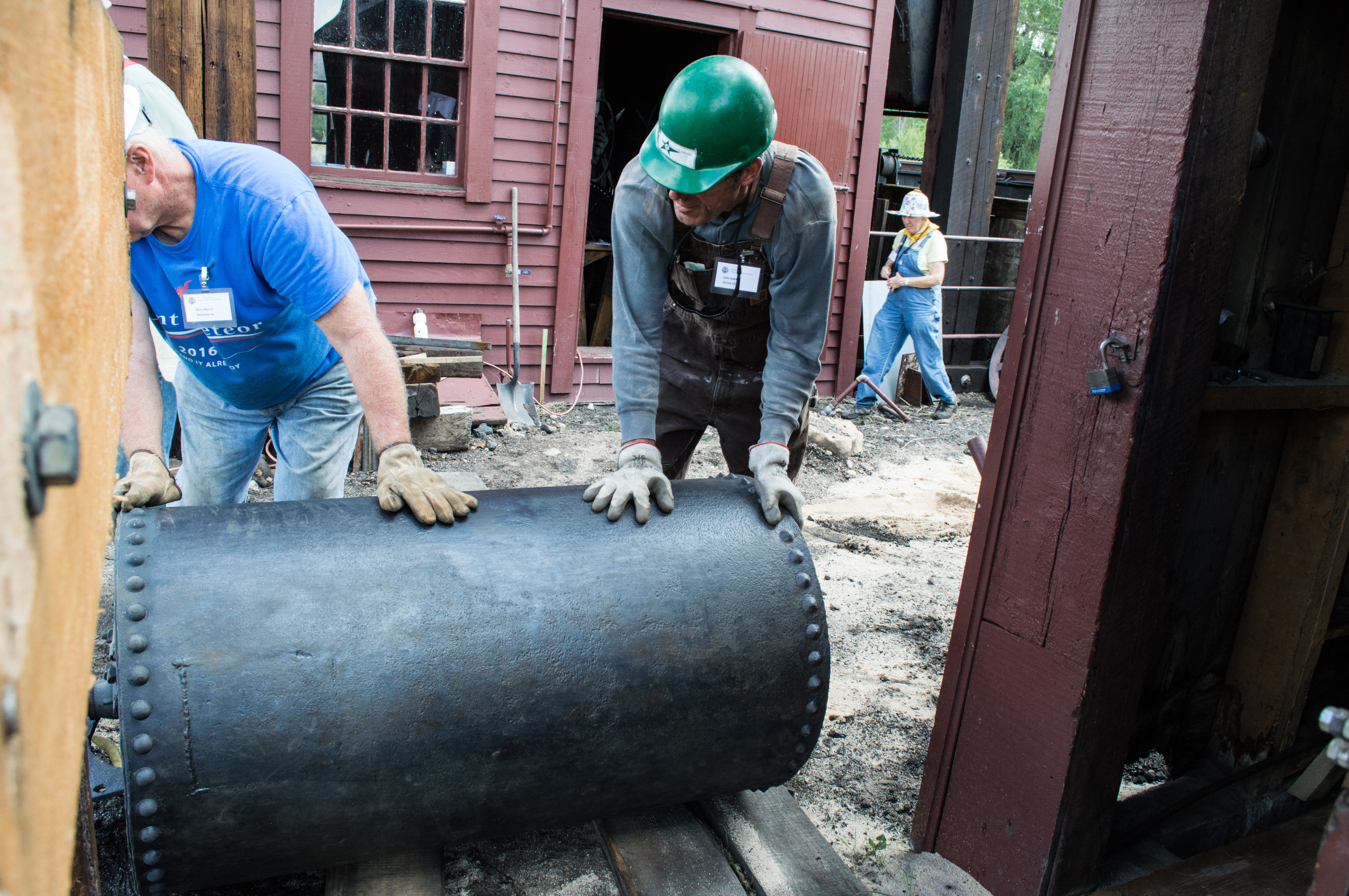

The crew now man handles the tank along the boards

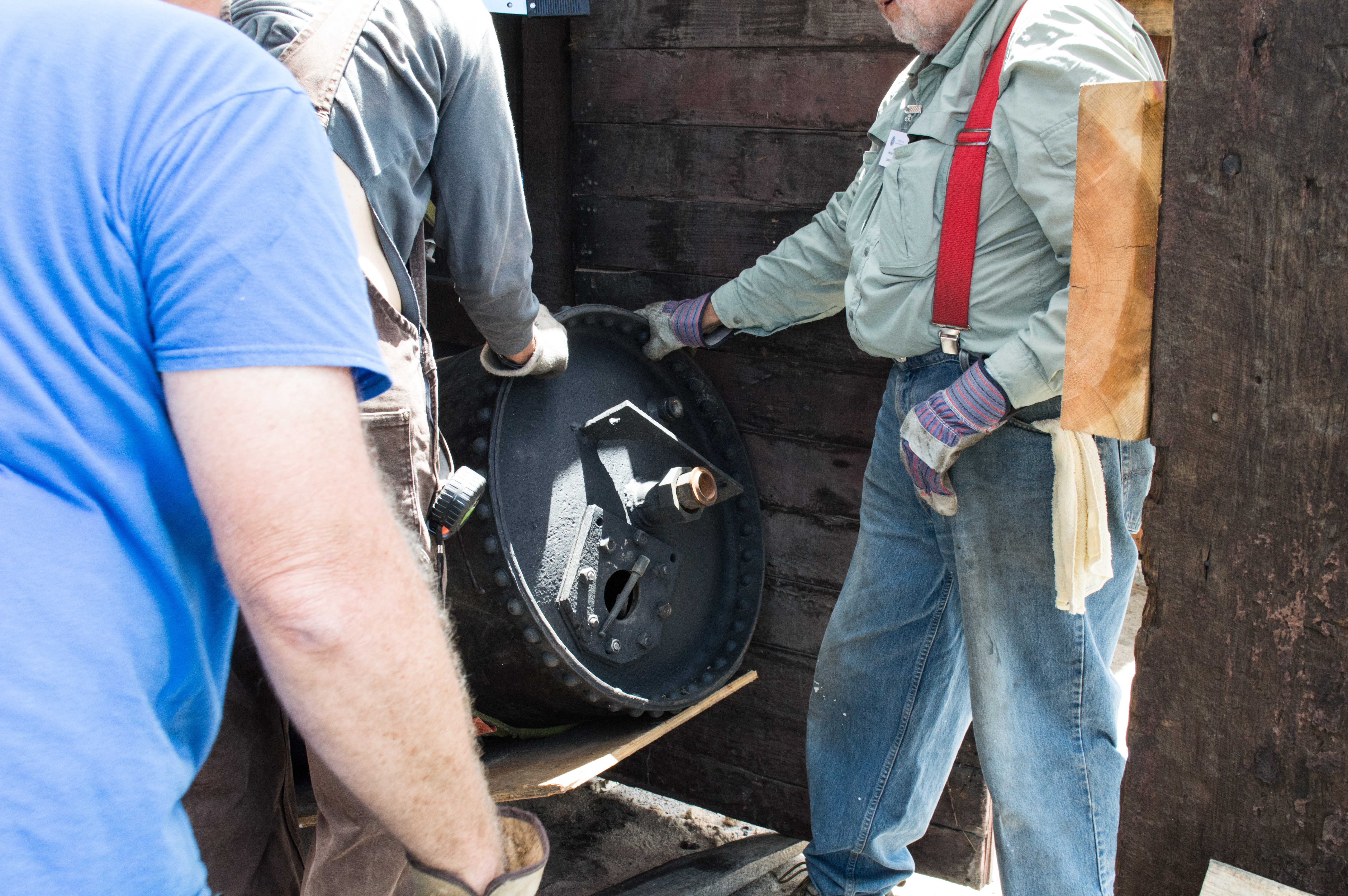

They now have the tank starting to tip over into the pit where it will reside

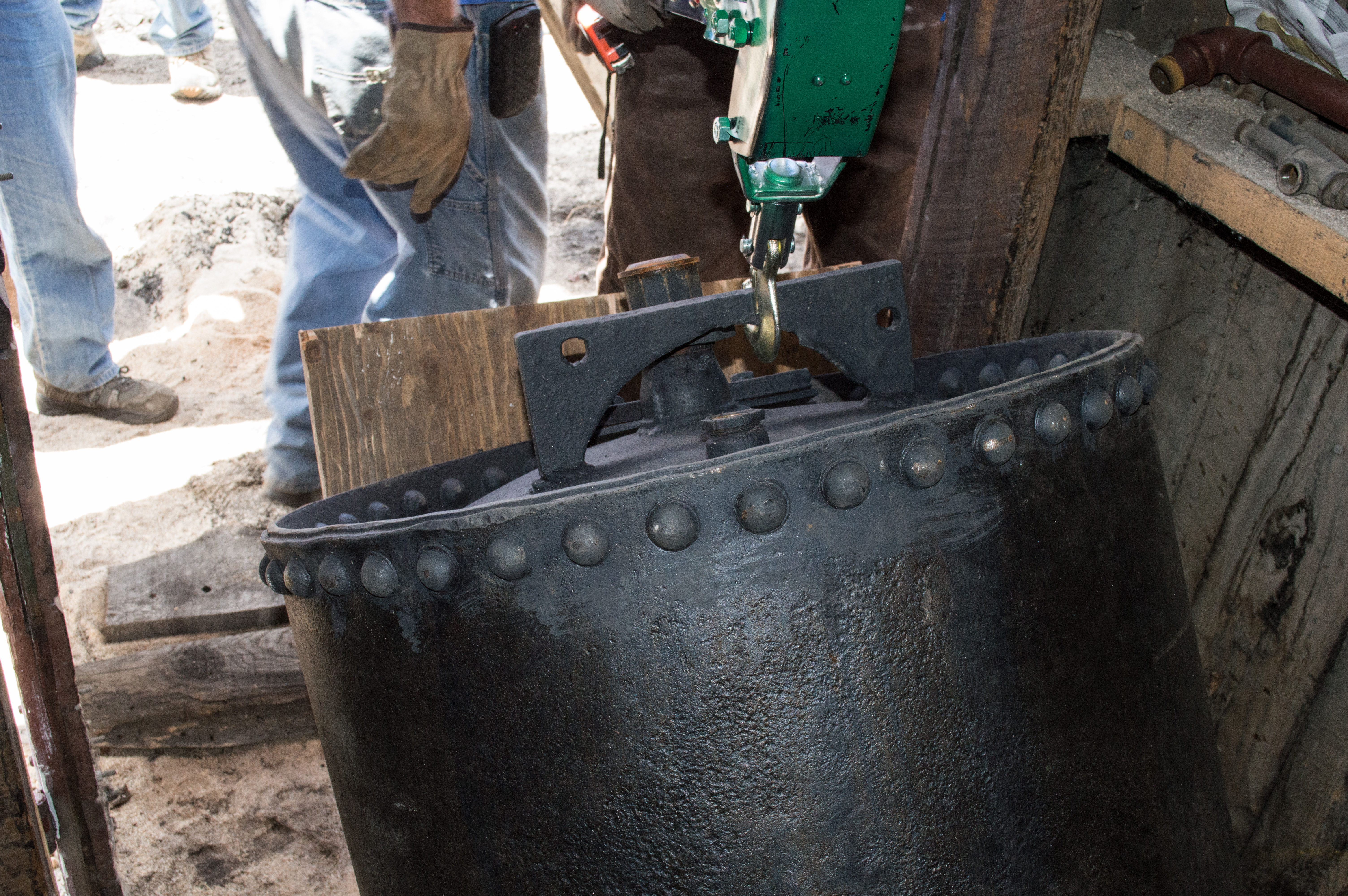

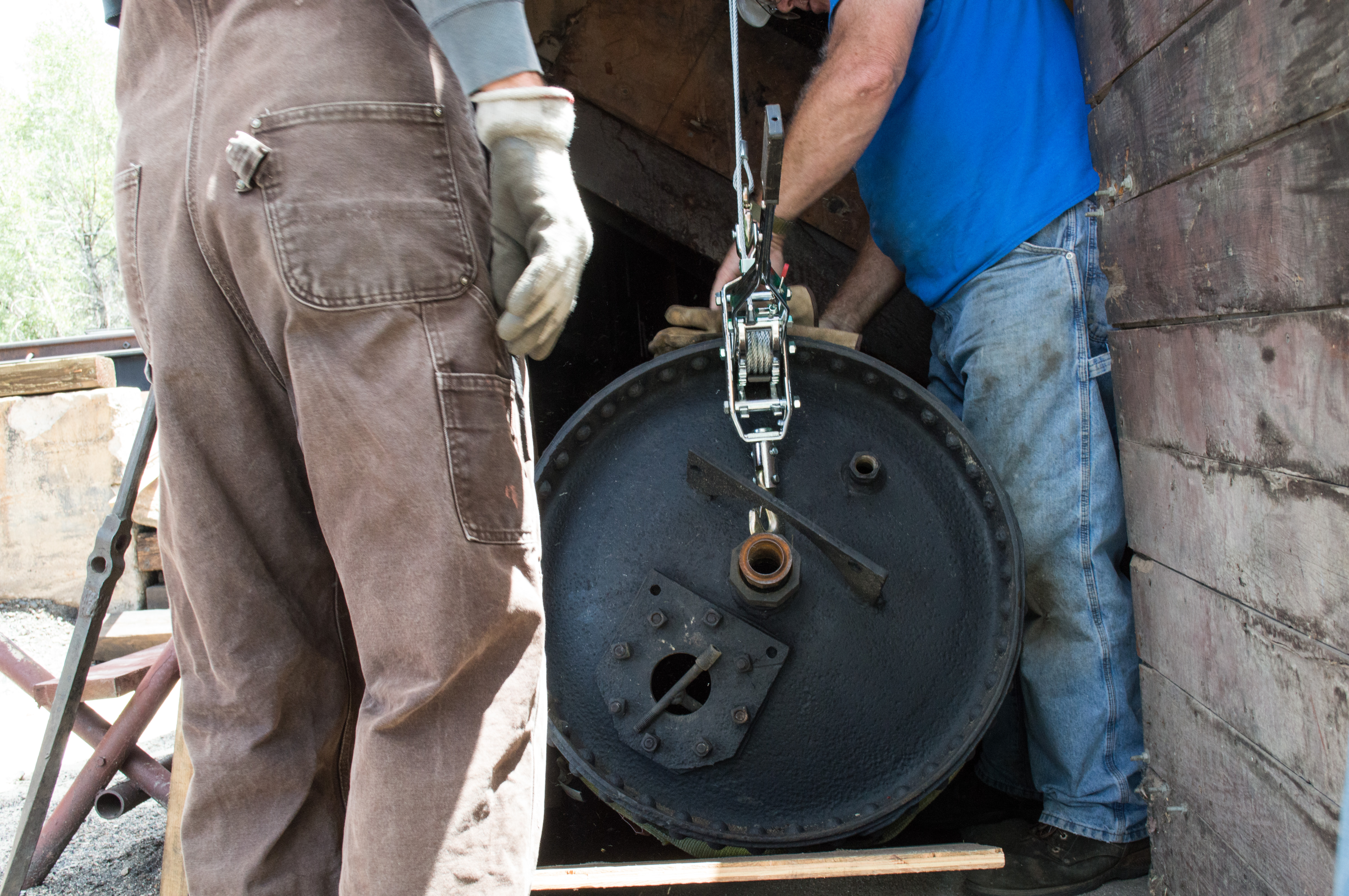

The crew has moved the tank far enough to attach the come-along directly to the top of the tank
Lowering is begining

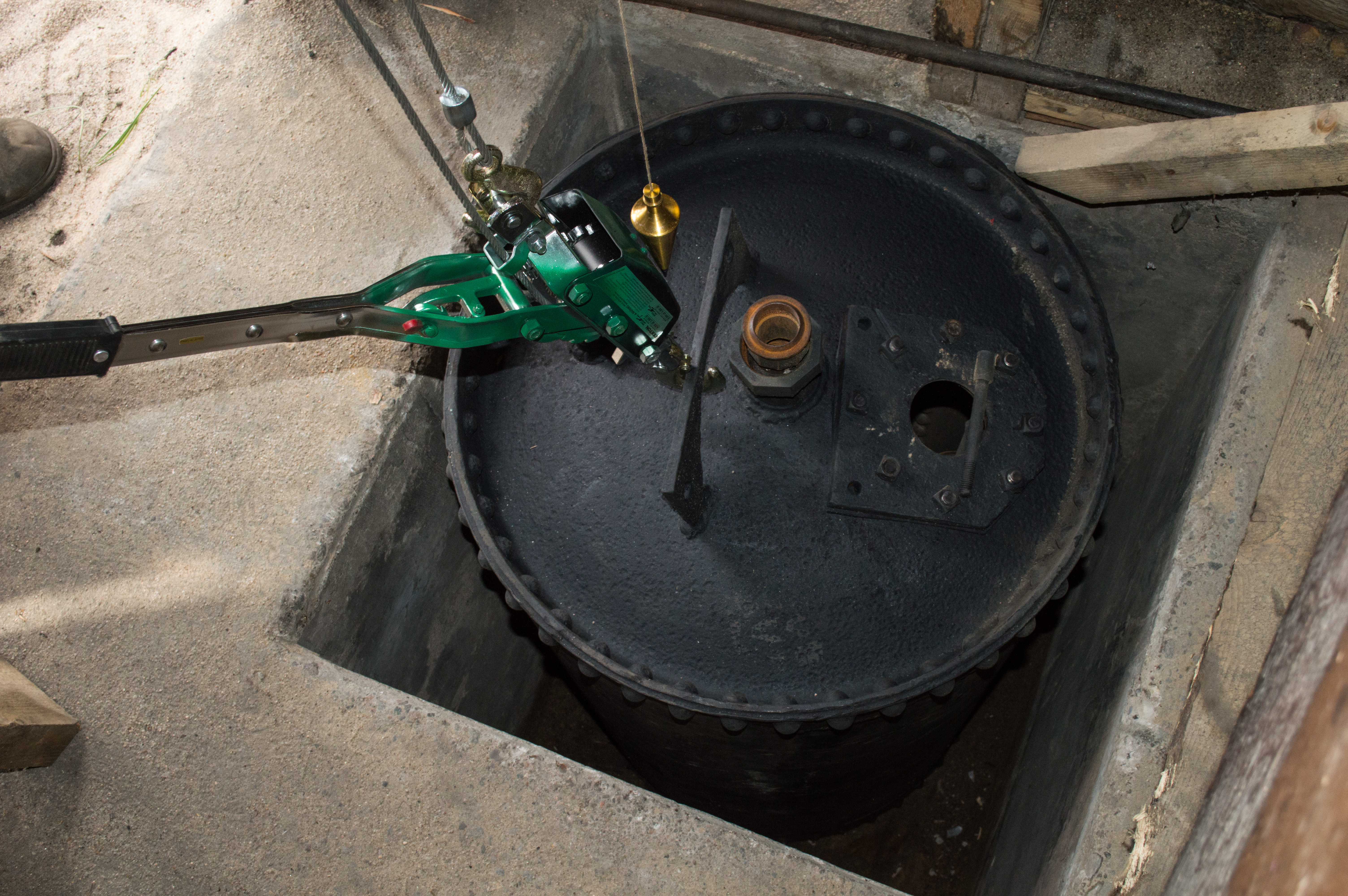

7-26-17 Before the tank is lowered the last few inches a plumb bob was lowered from the roof through the pipe hole so the tank could be centered.jpg
Before the tank is lowered the final few inches, a plumb bob was lowered through the hole in the roof where the air pipe needs to go to ensure alignment

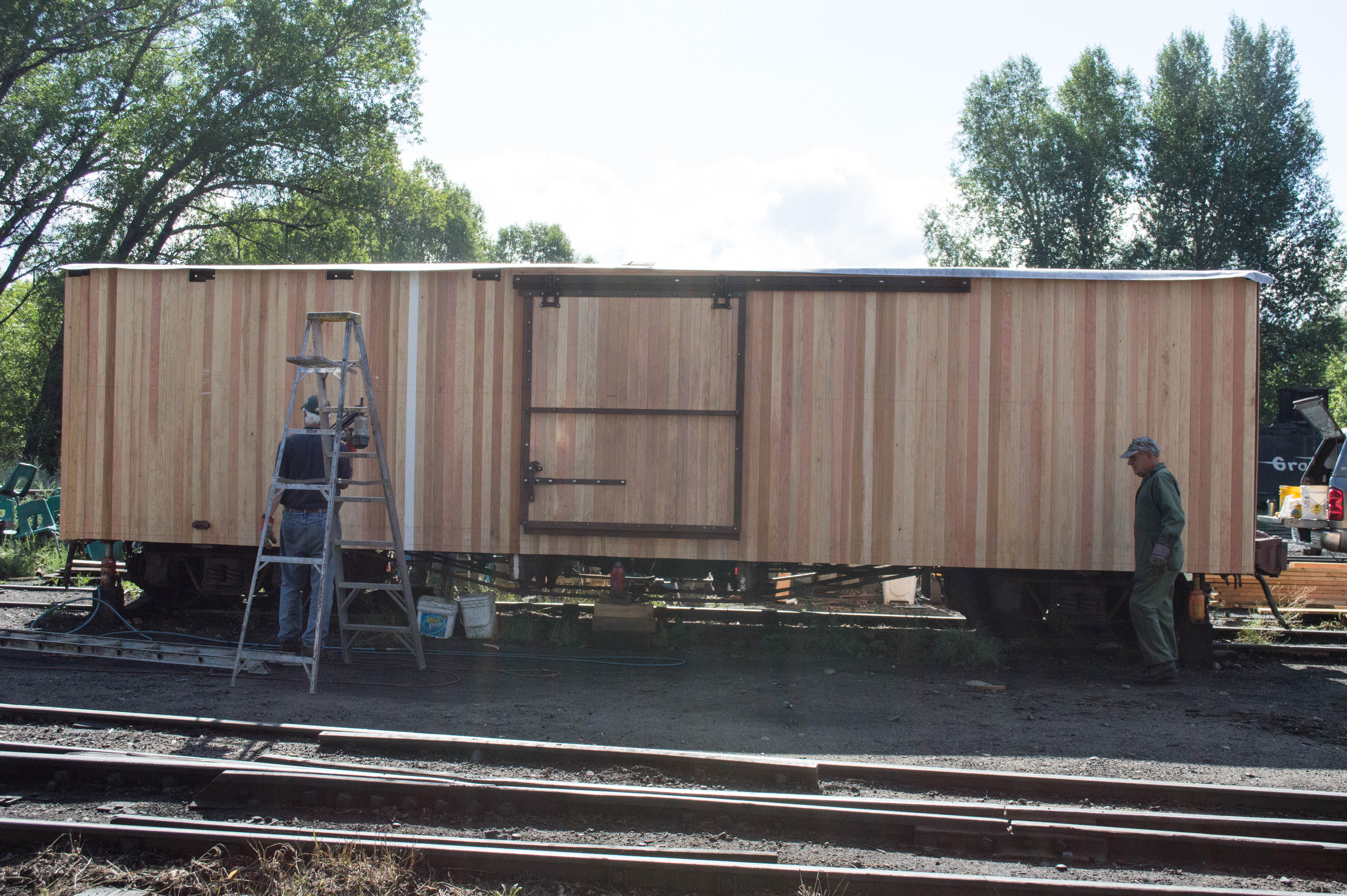

Now the conversion of the p box to box car 3537 for Wednesday.
The newly constructed door for the left side of the car is almost ready to install. The MOW bunk car can be seen in the background.

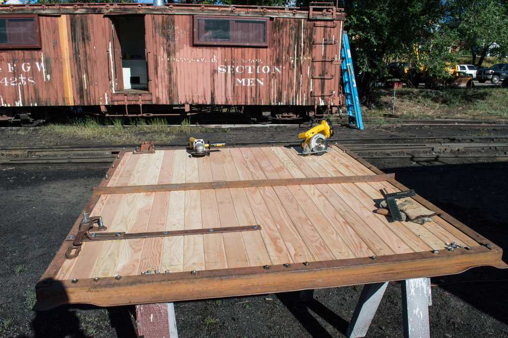

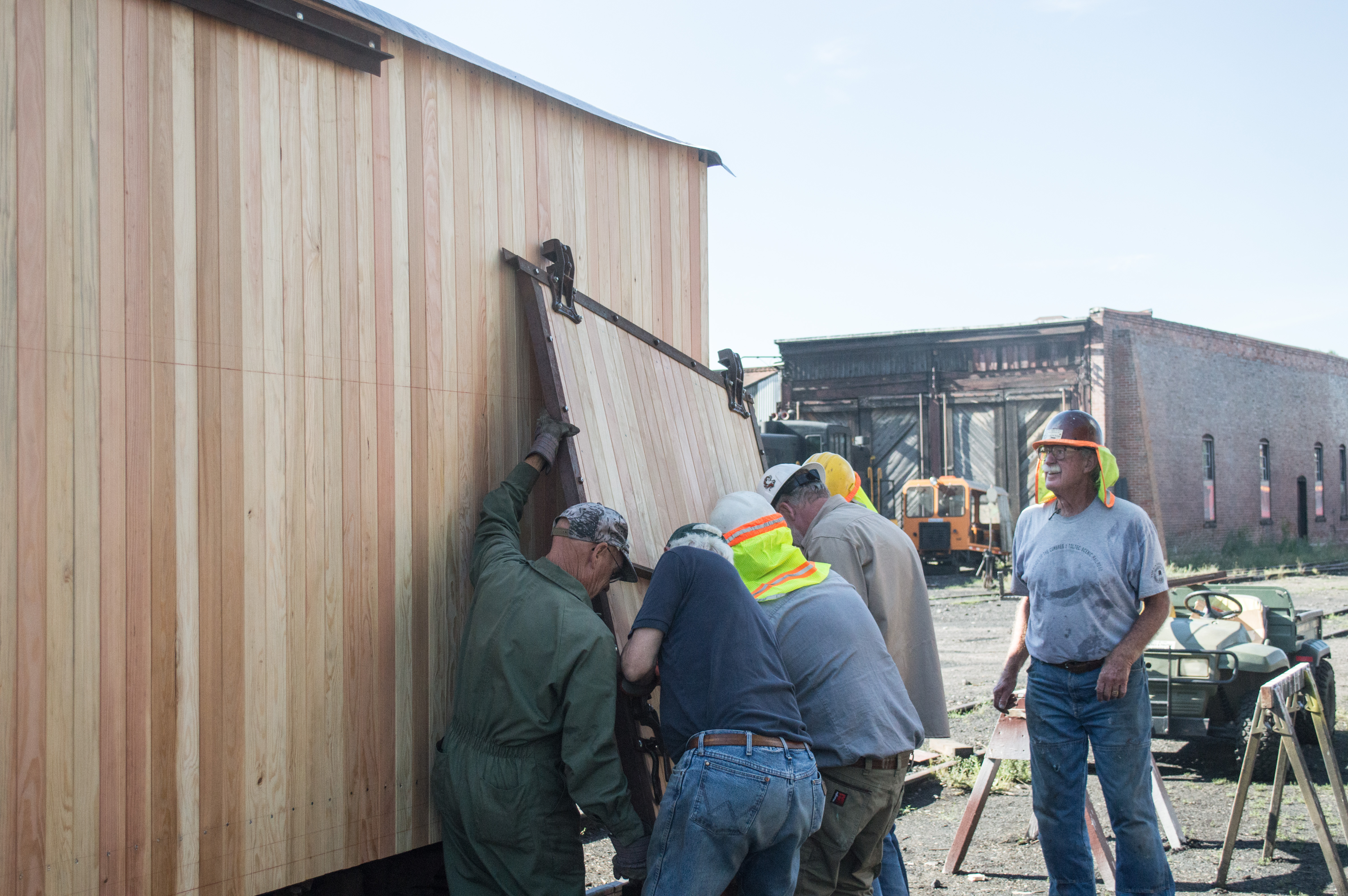

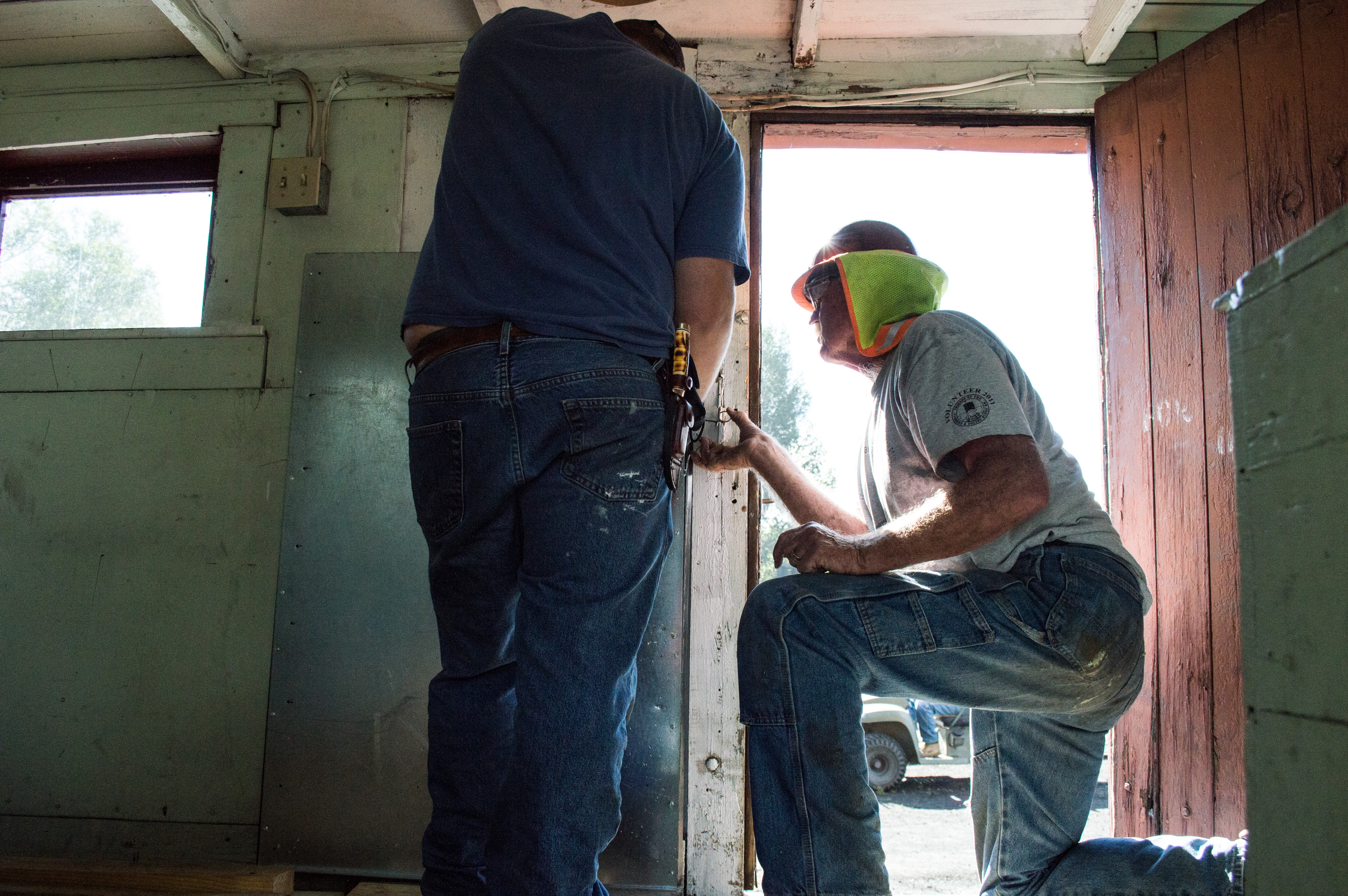

The full crew of the 3537 is man handling the door up onto the track as Dr. McMullen from the bunk car acts as spotted

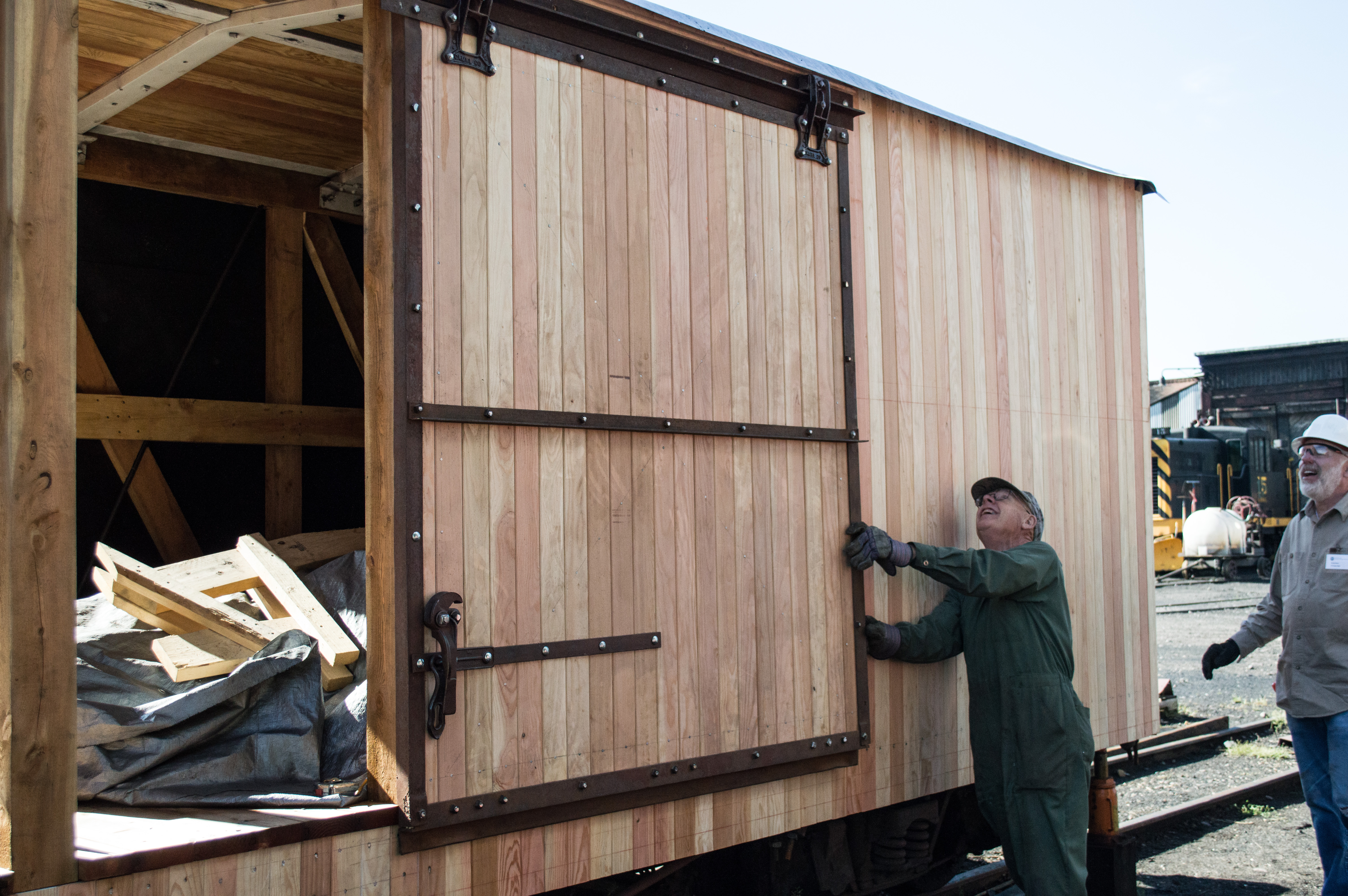

The door is on and Don Bayer is checking to see how freely is rolls
Shot of the left side of the 3537 with the door on and closed

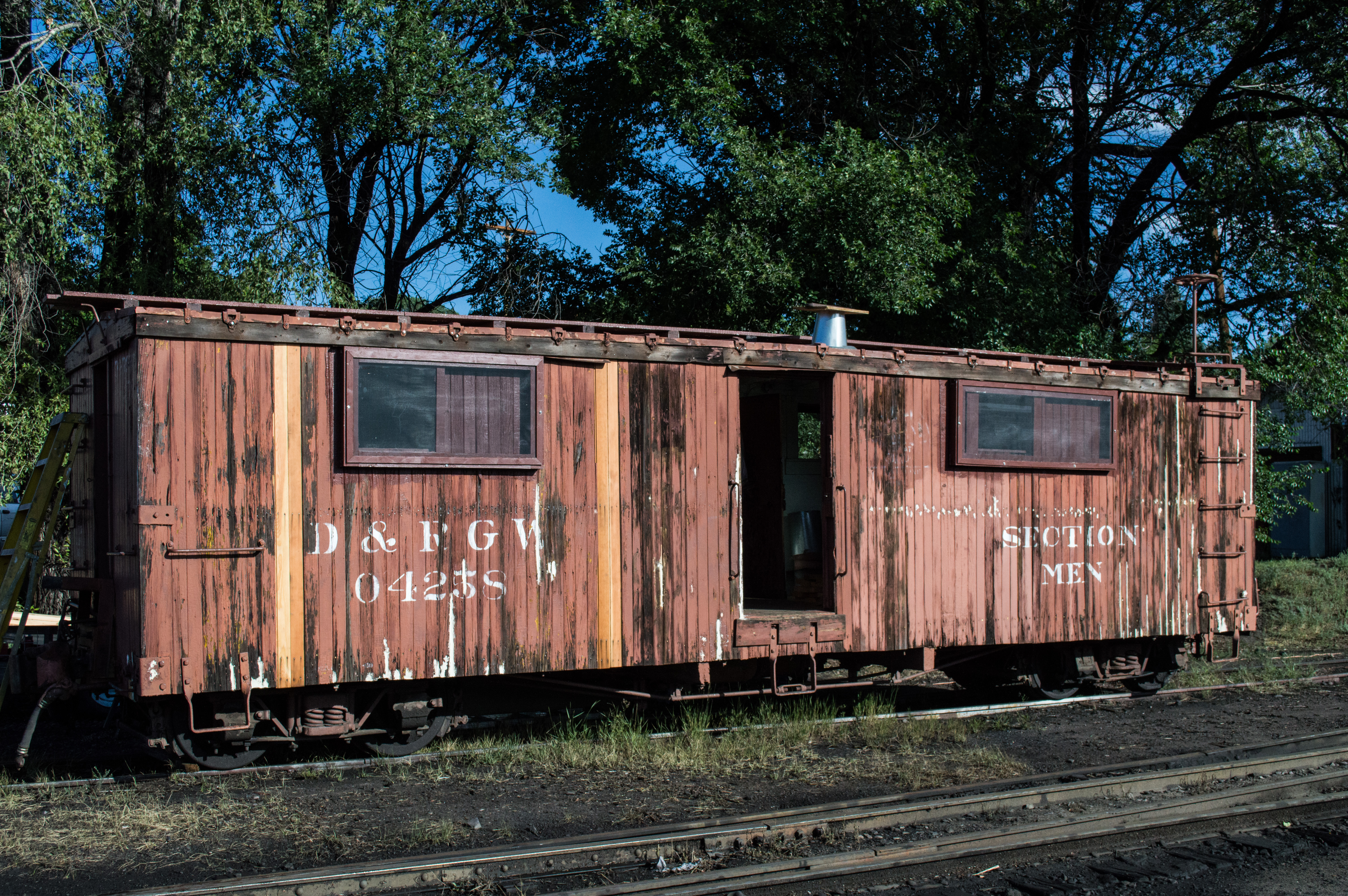

Moving across the tracks to the bunk car.
The windows have been attached to the car. Unbeknown to the crew they would have to remove them for the car to be painted

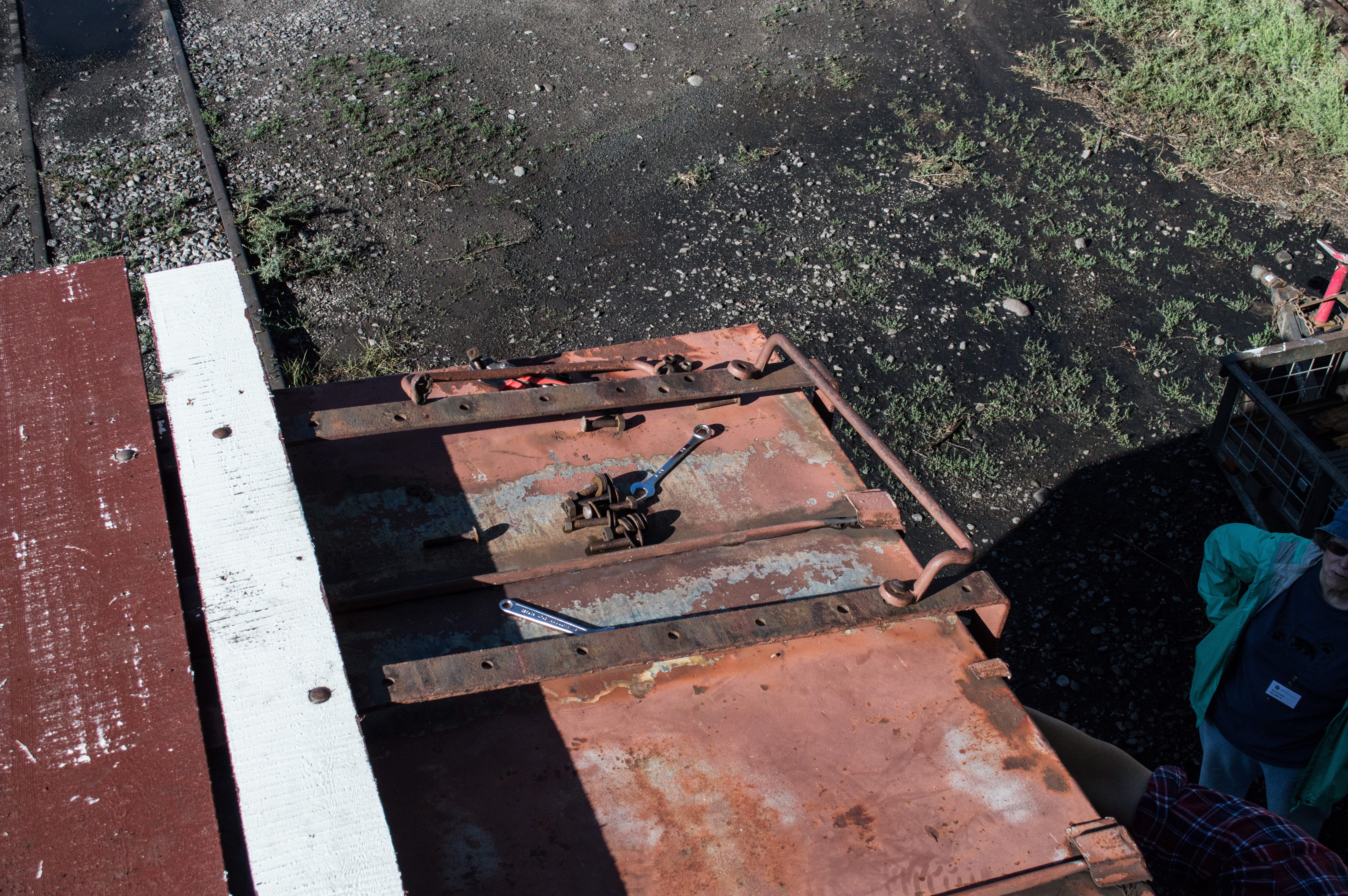

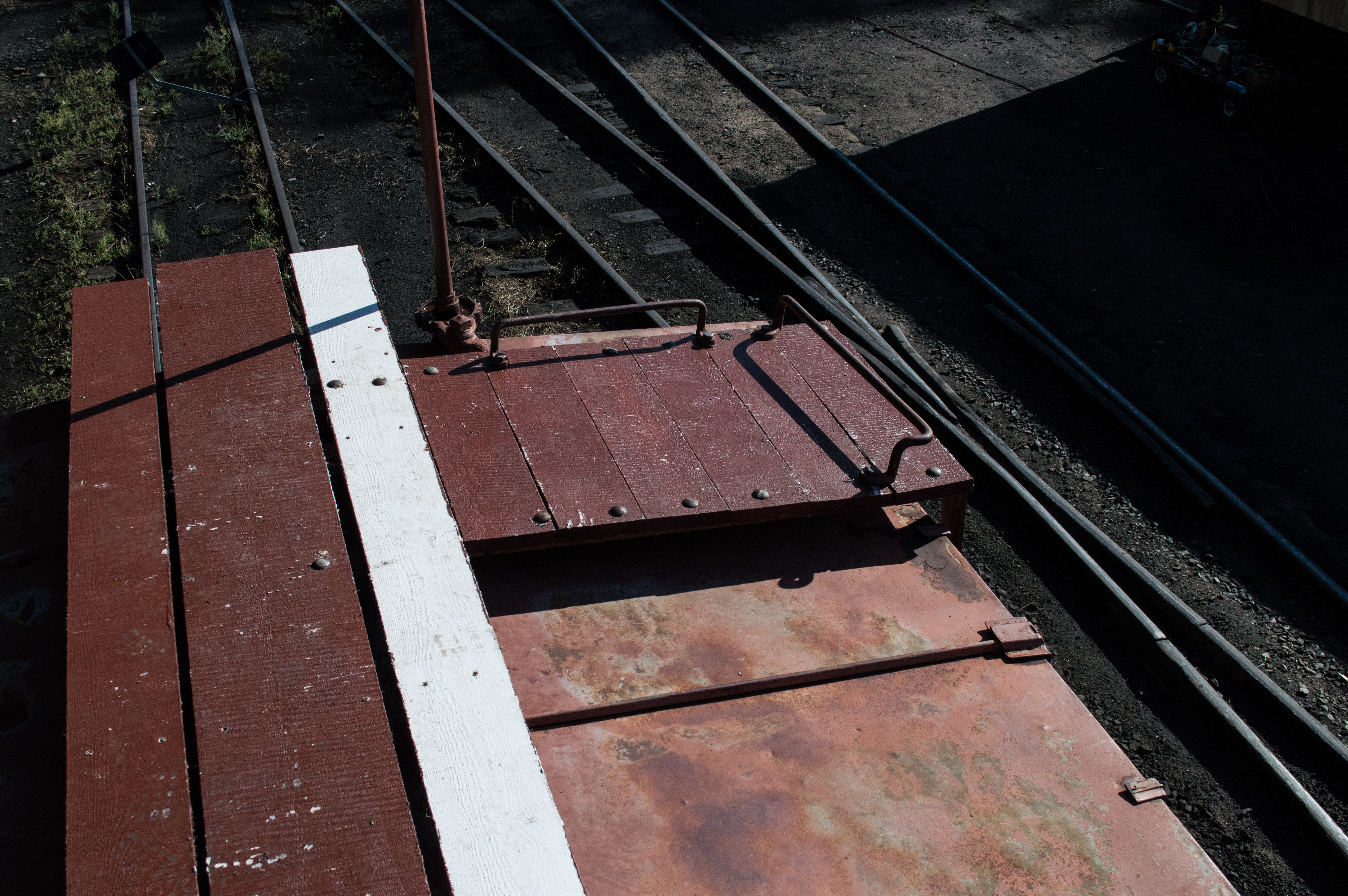

This shot shows the hardware for the roof step before the wood is attached, and no I did not climb up there for these shots
The after shot with the boards attached
