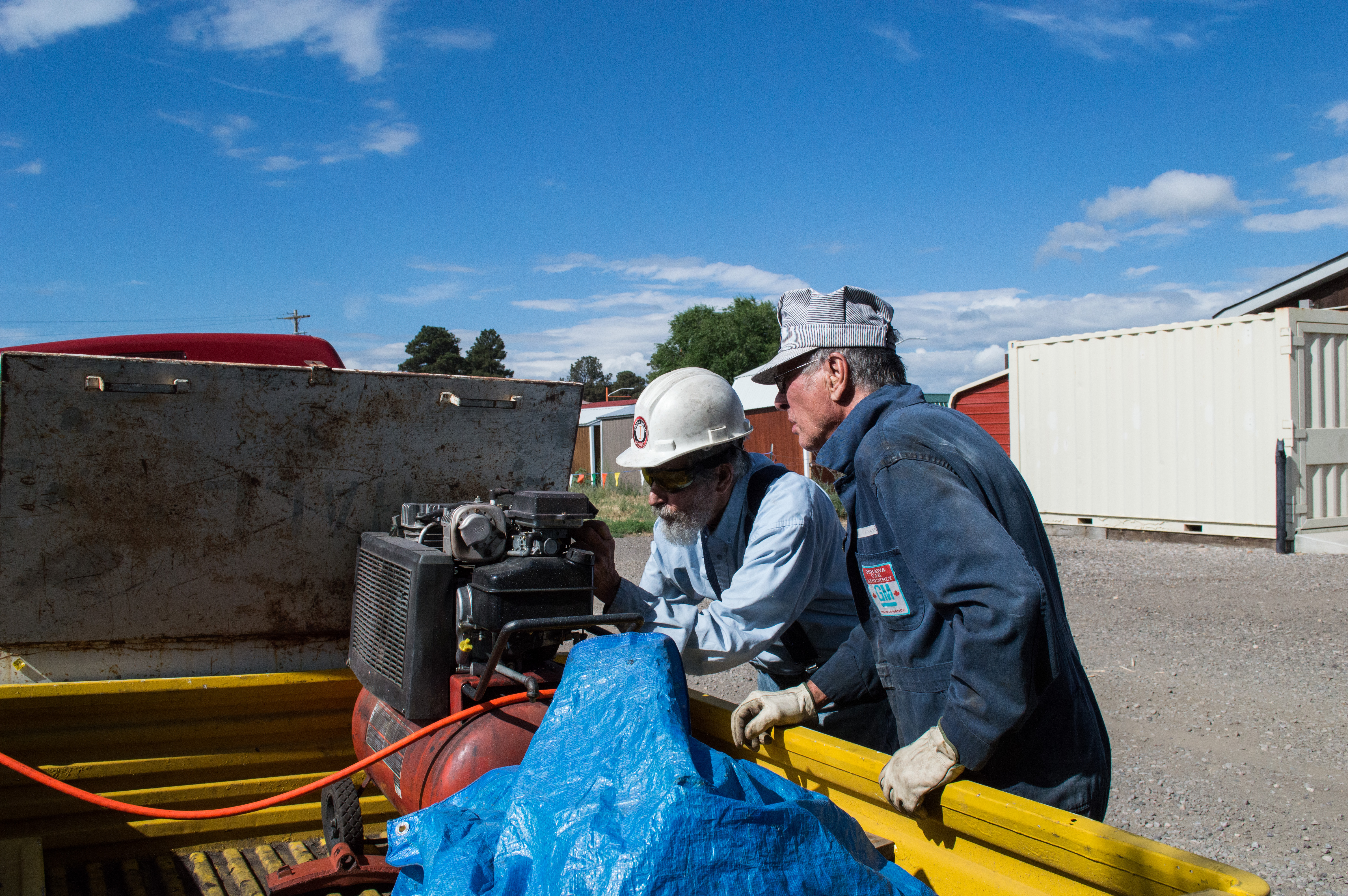

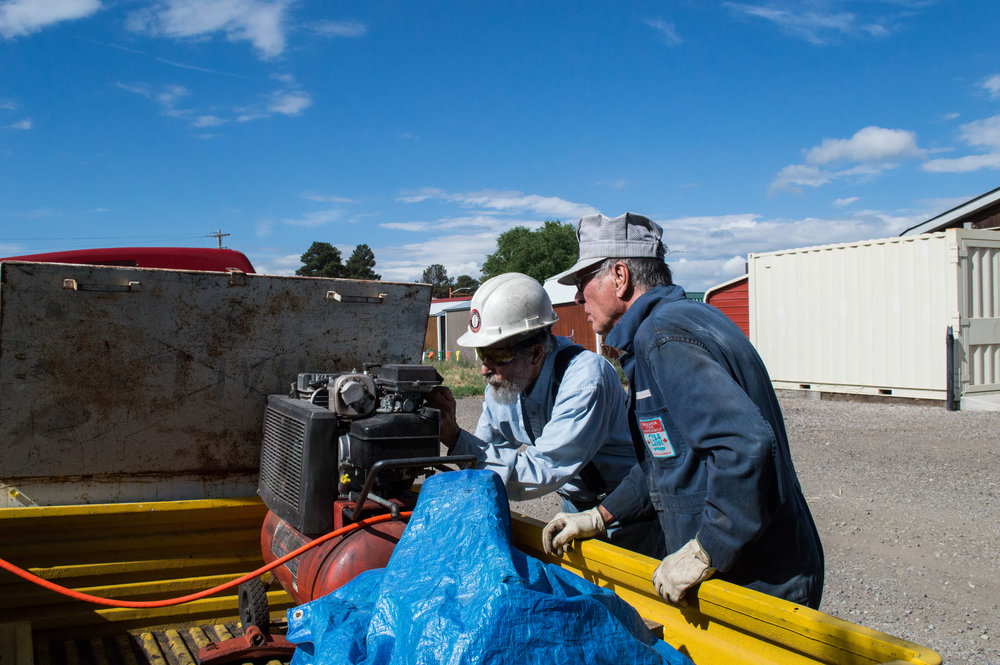

An air compressor is a vital piece of equipment when testing air brakes

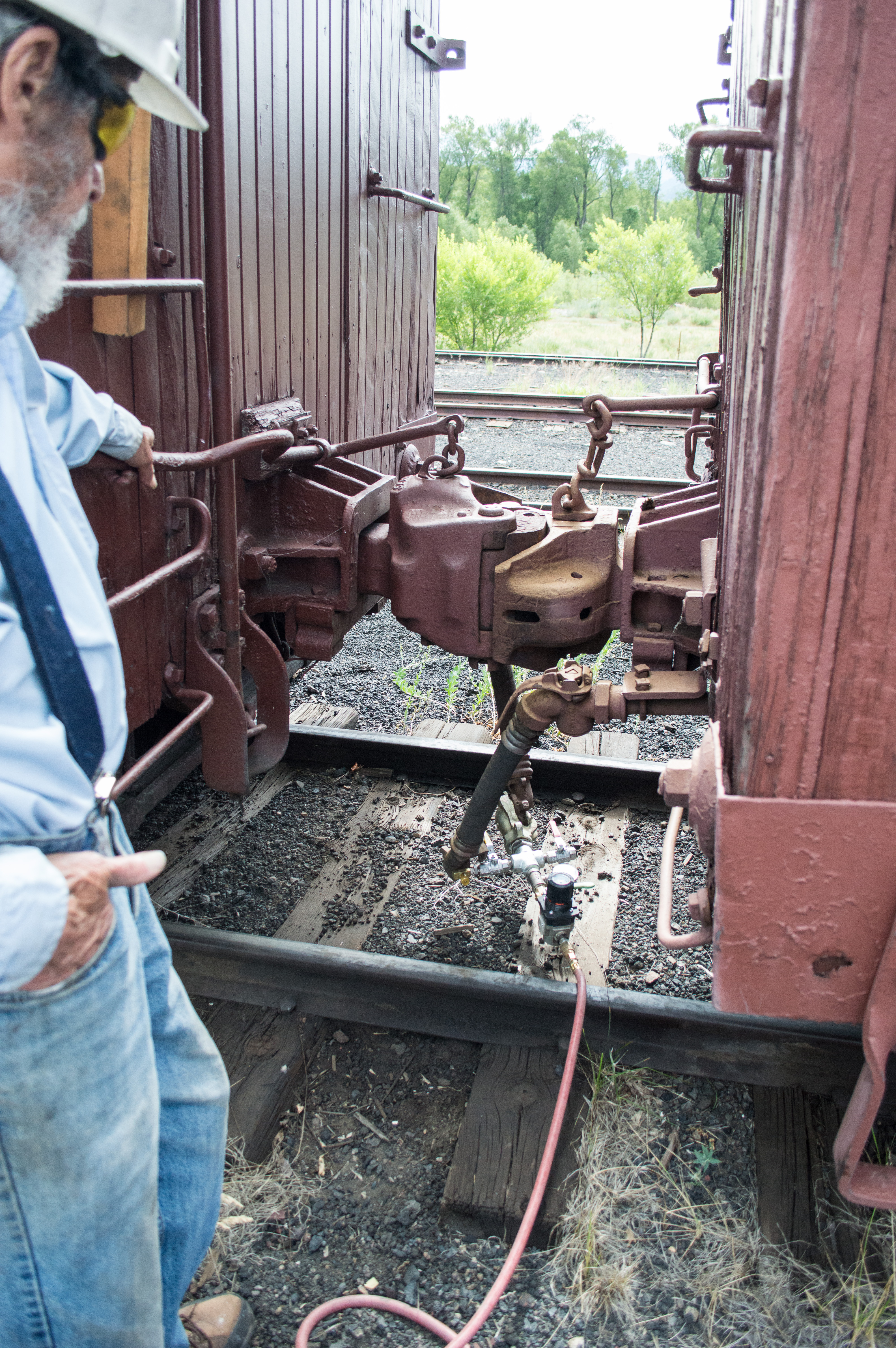

This is the set up for testing with the air line coming into the actual testing rig that is hooked to the car's gladhand

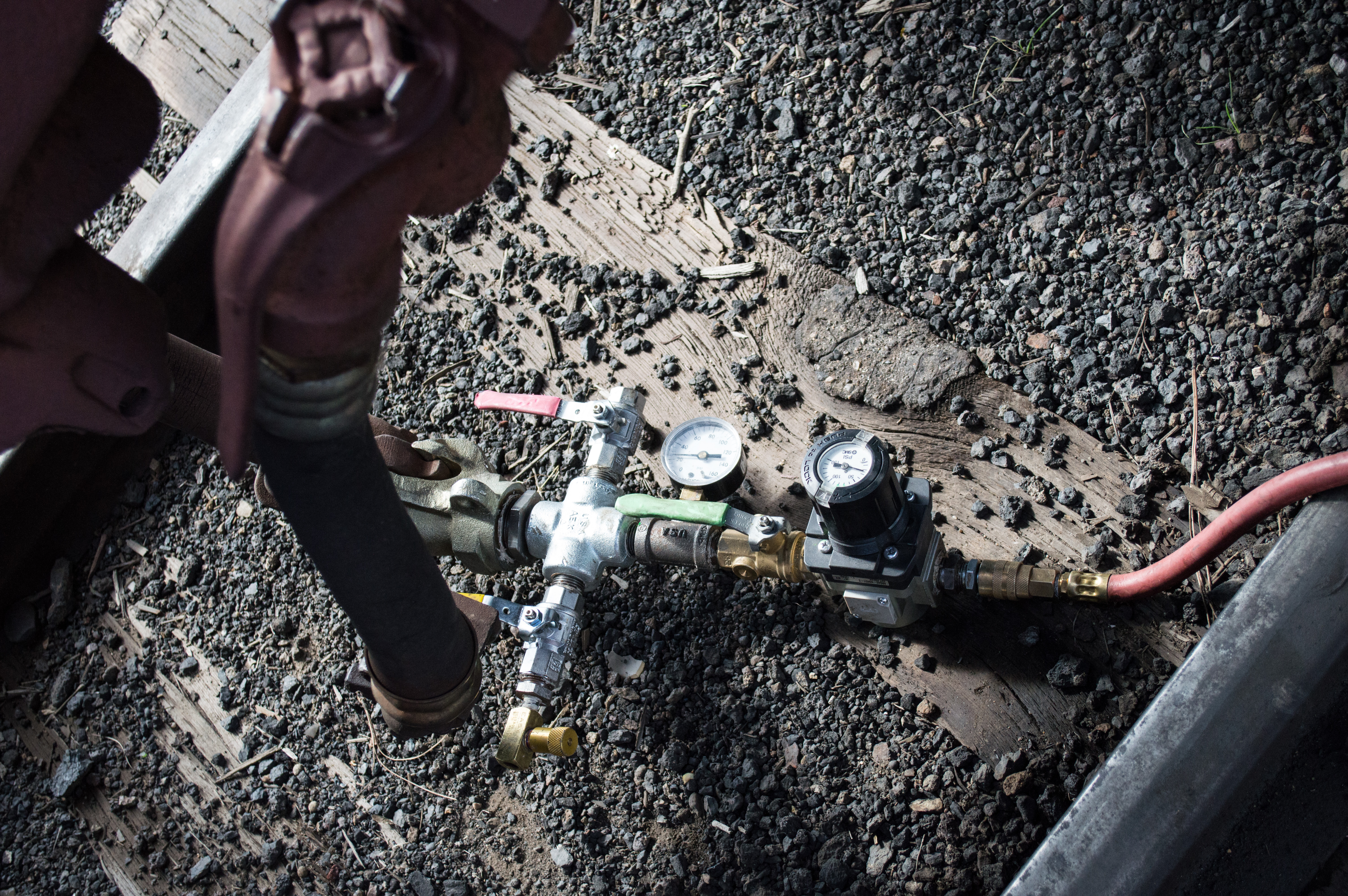

This is a close up view of the testing rig. The green valve is the "train line", the red one "emergency application" and the yellow "normal set", it has a needle valve to restrict flow out from it.

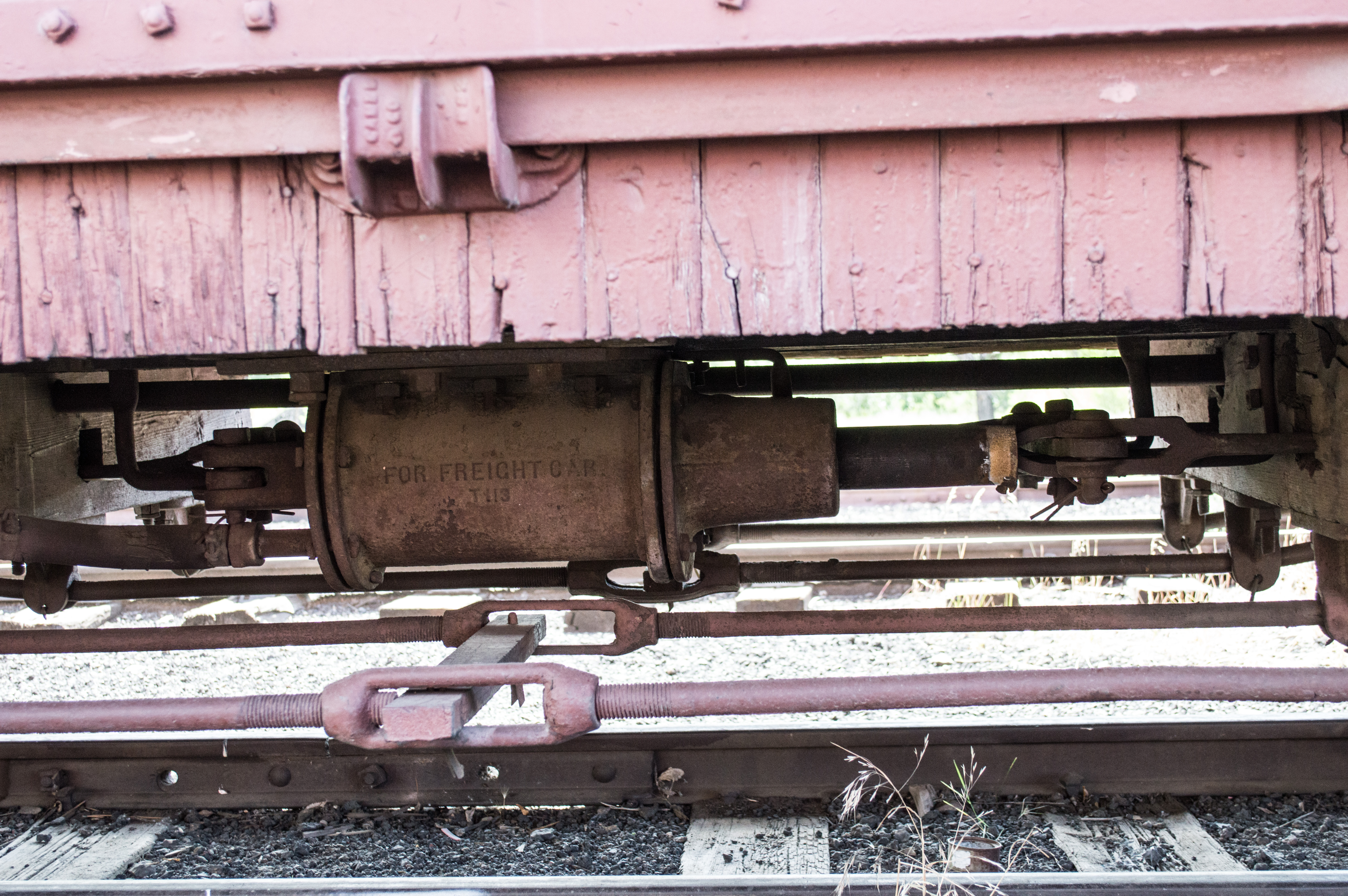

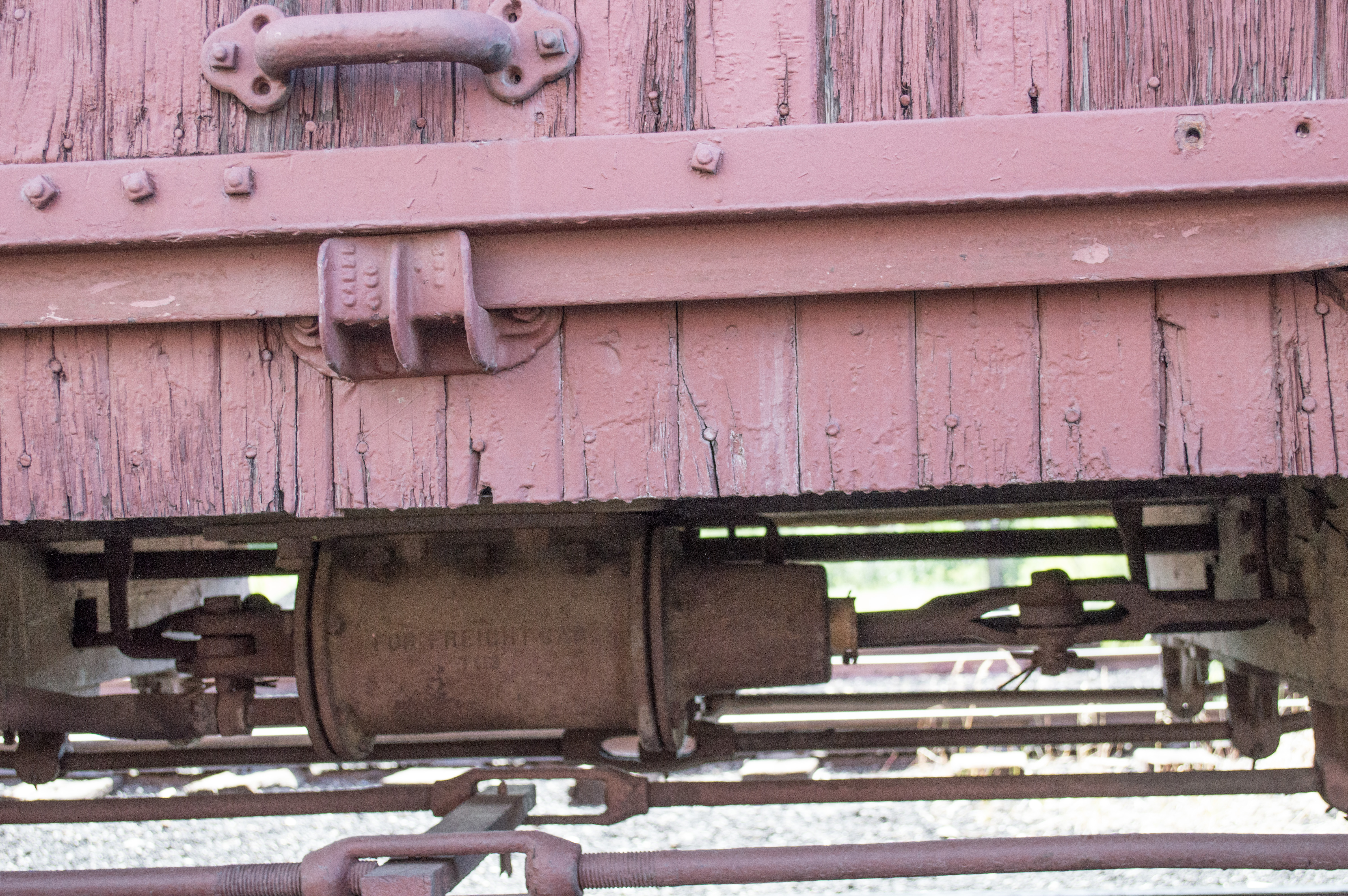

Car's brake cylinder in the release position
and in the full applied position

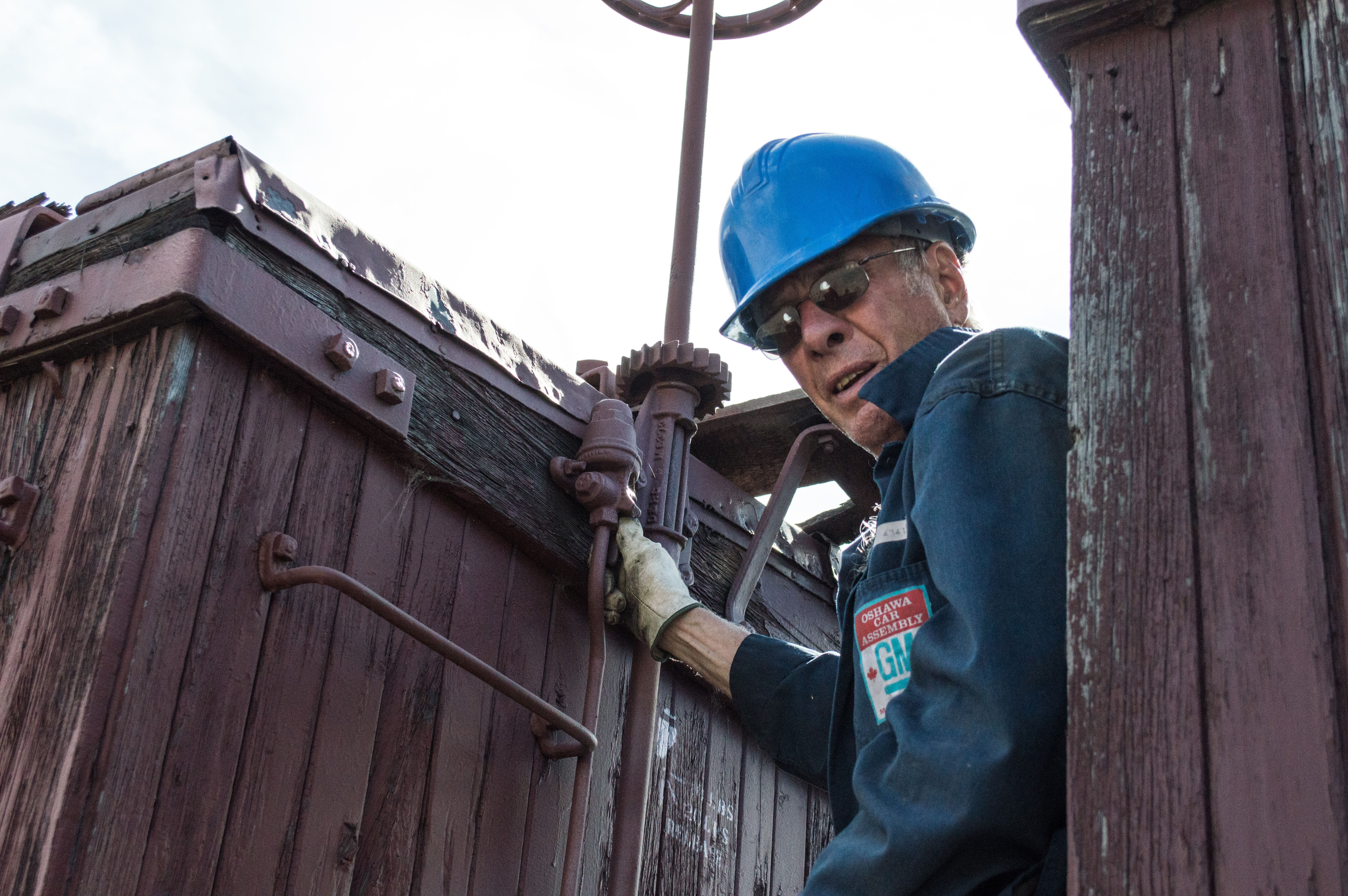

The retainer valve on the older box cars was at the top of the ladder that went up to the brake wheel

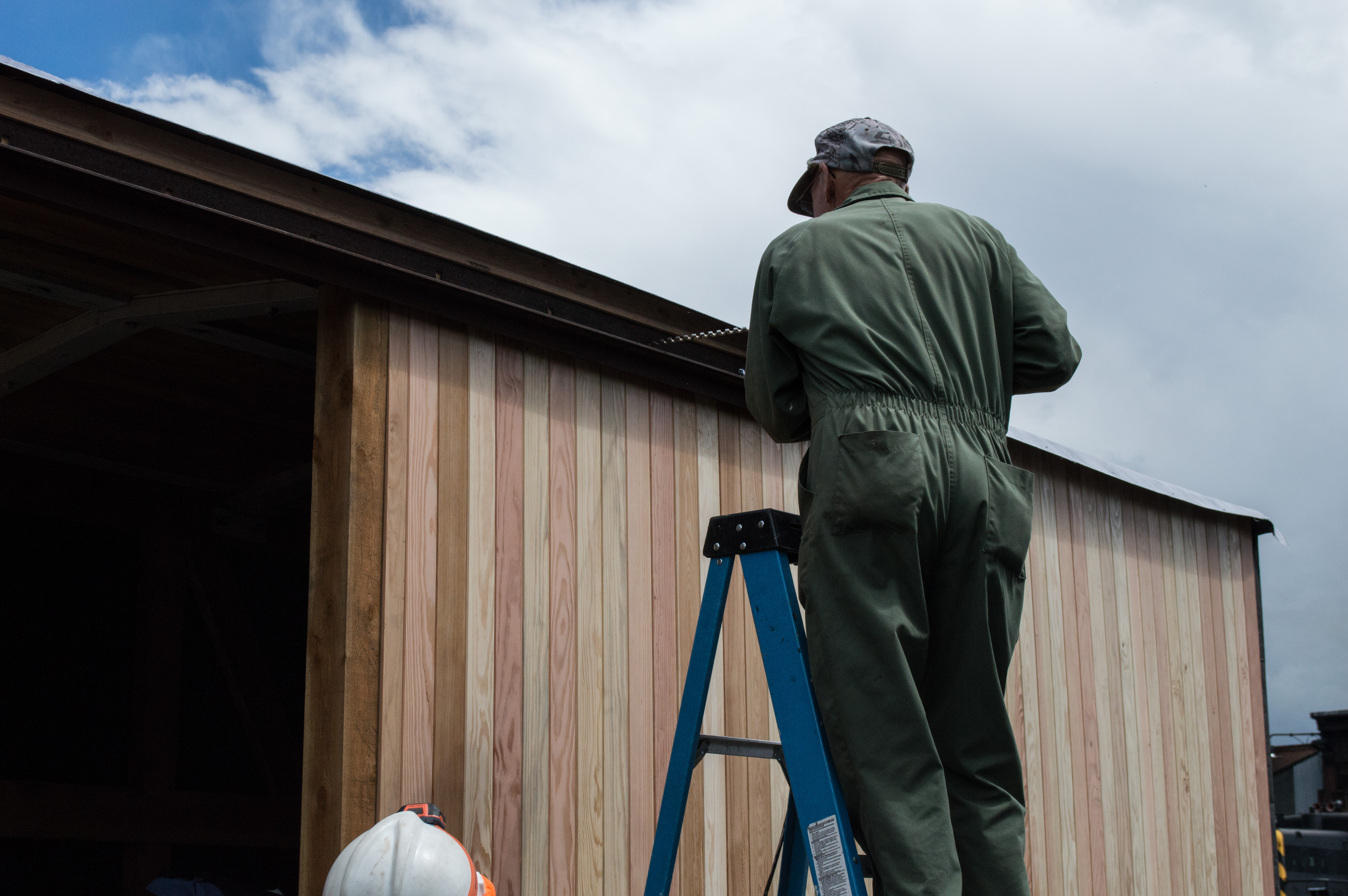

The conversion of the passenger box car back to a box car which contains benches and can be used in photo freights is coming along.
One end is done as well as the west side as it sits. The other end, seen here, is just about finished and the other side will be done either this afternoon or in the morning

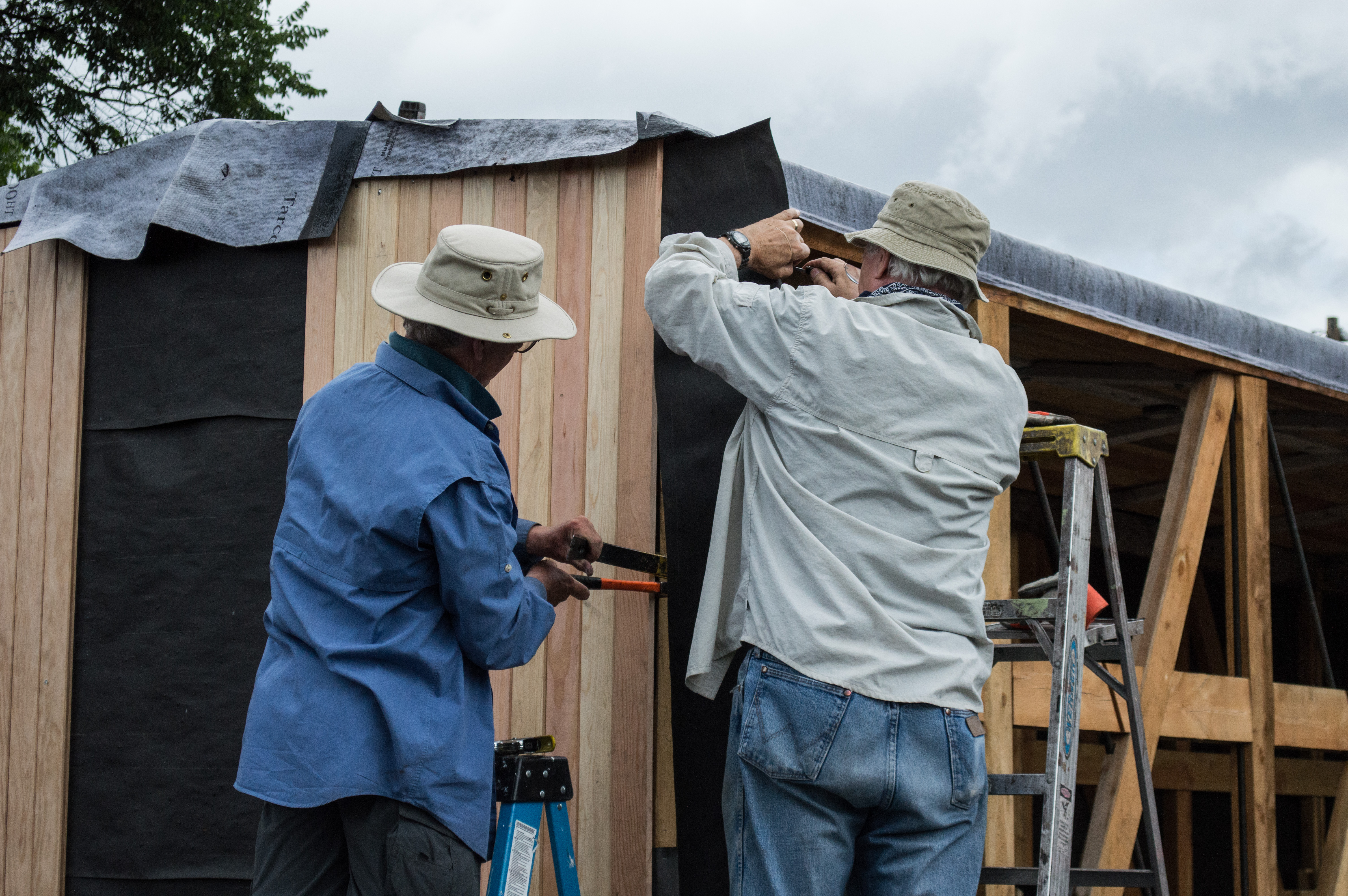

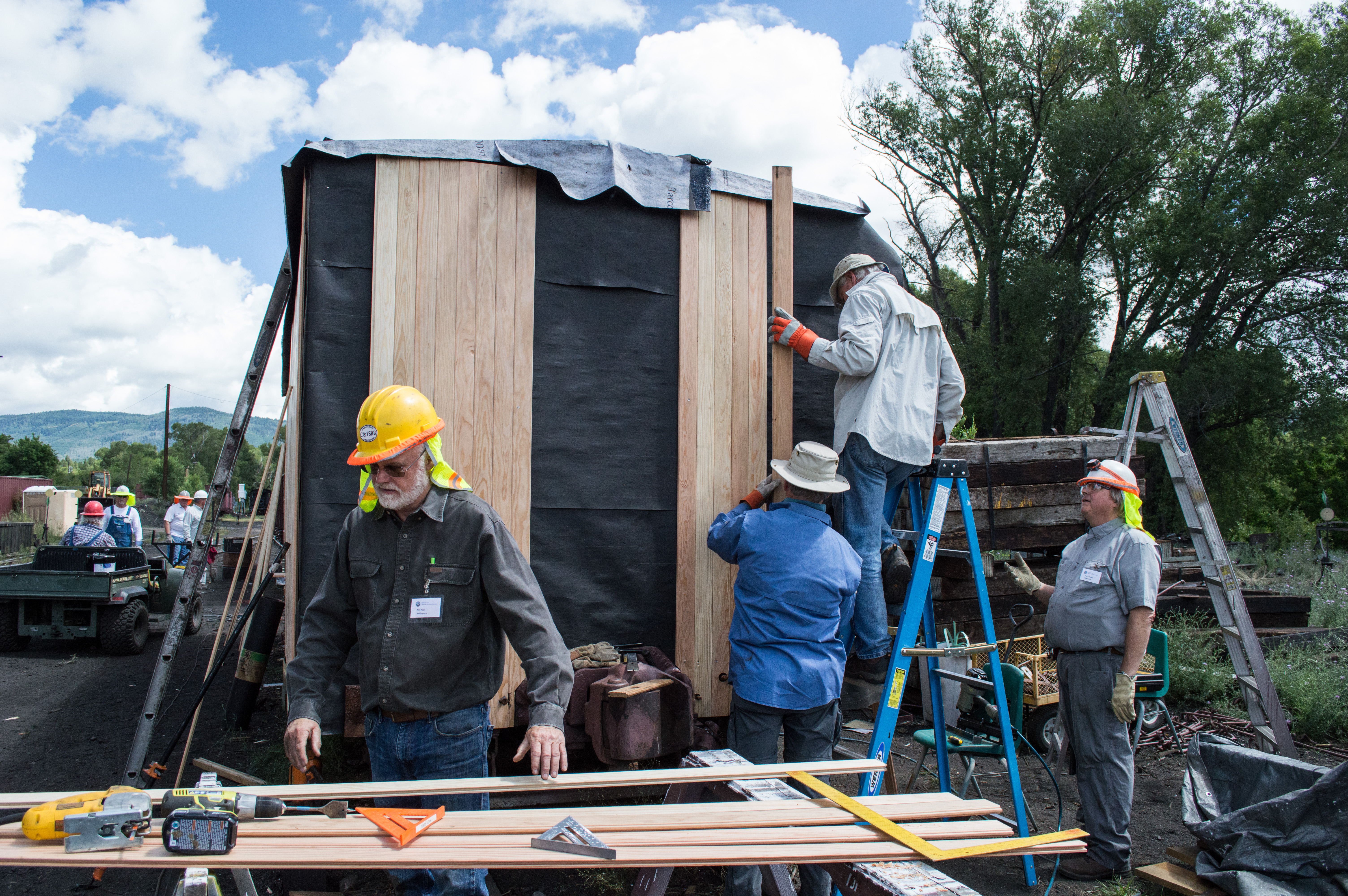

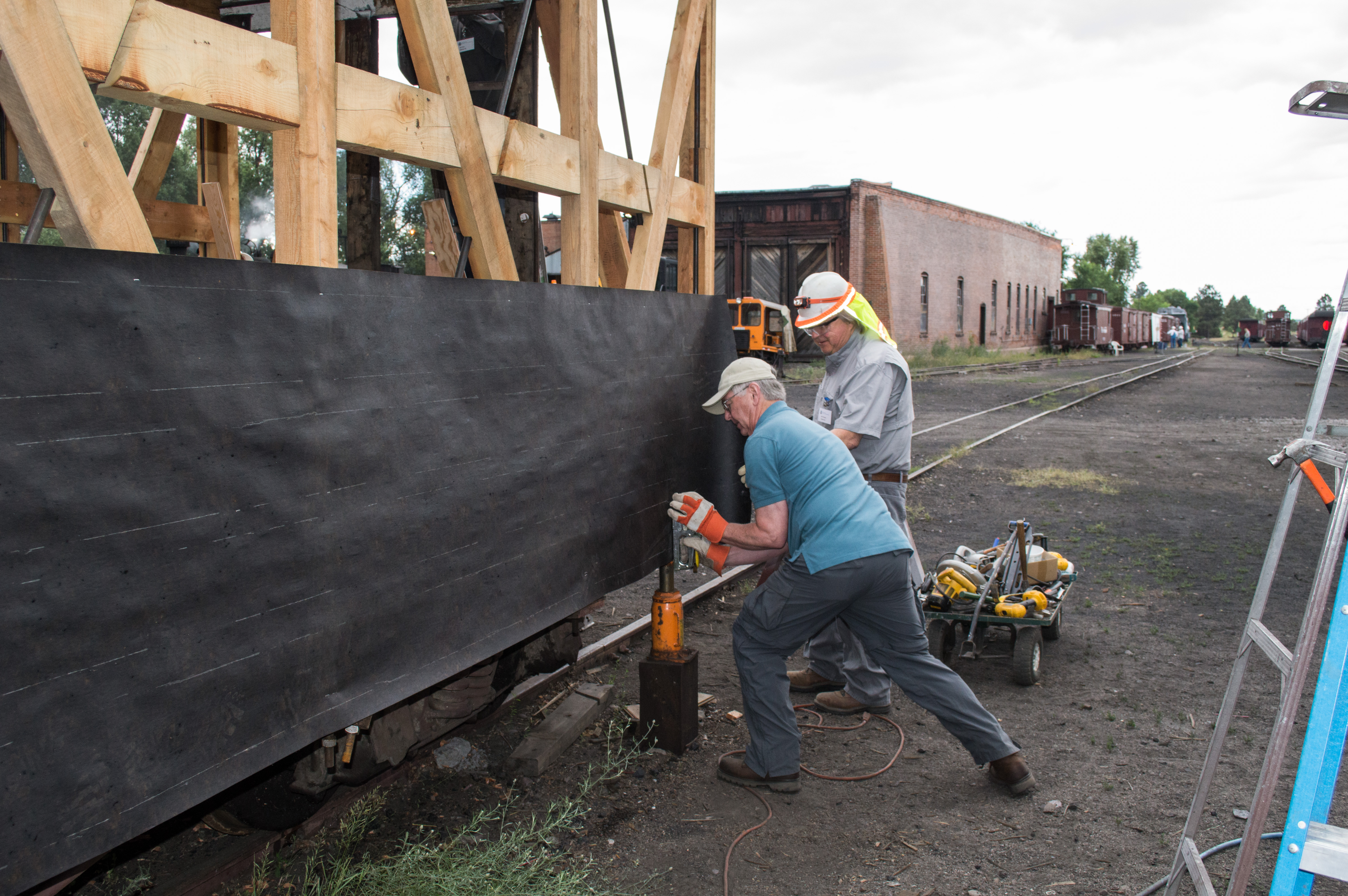

The crew is wrapping the car with waterproof sheathing before putting on the boards

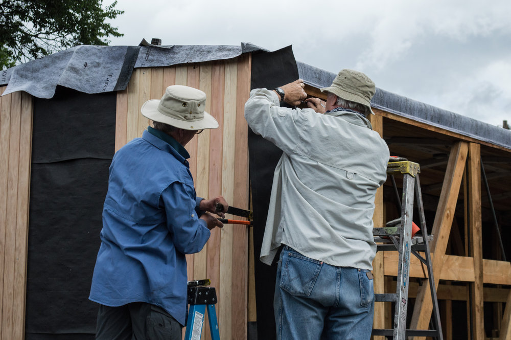

Randy and Robert are working in the corner and feeding the wrap behind the end boards prior to attaching the wrap on the right side of the car.

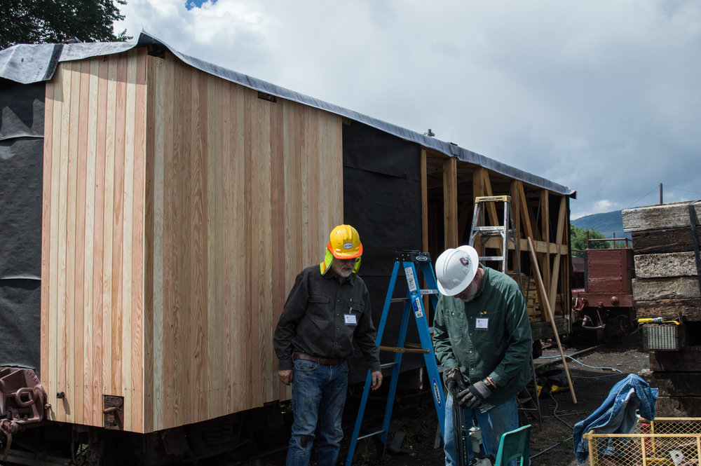

Don Bayer, team leader is drilling holes to attach the door guide to the left side of the car

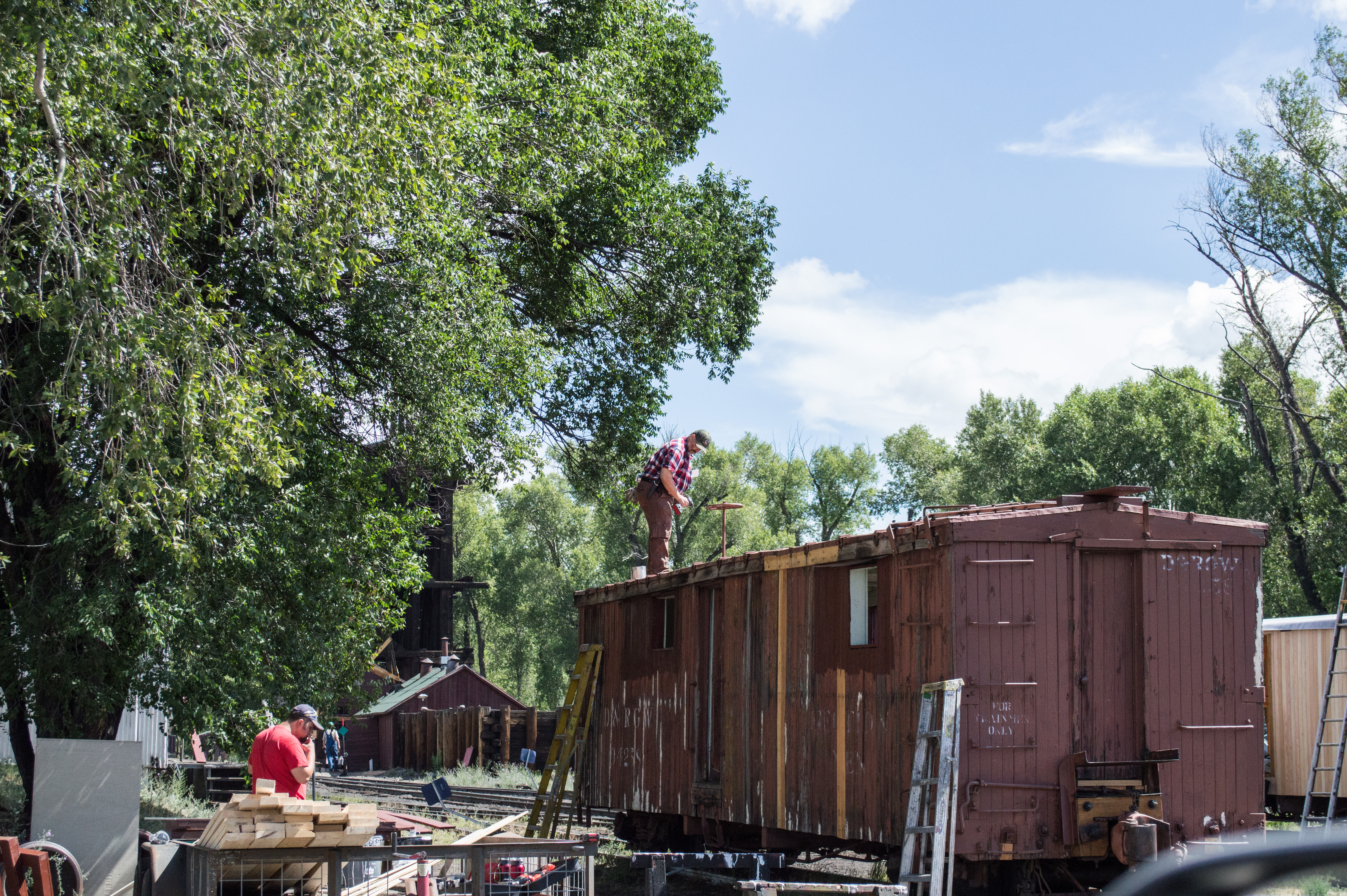

Over on the MOW bunk car:
Walter is on the roof getting ready to install the step boards

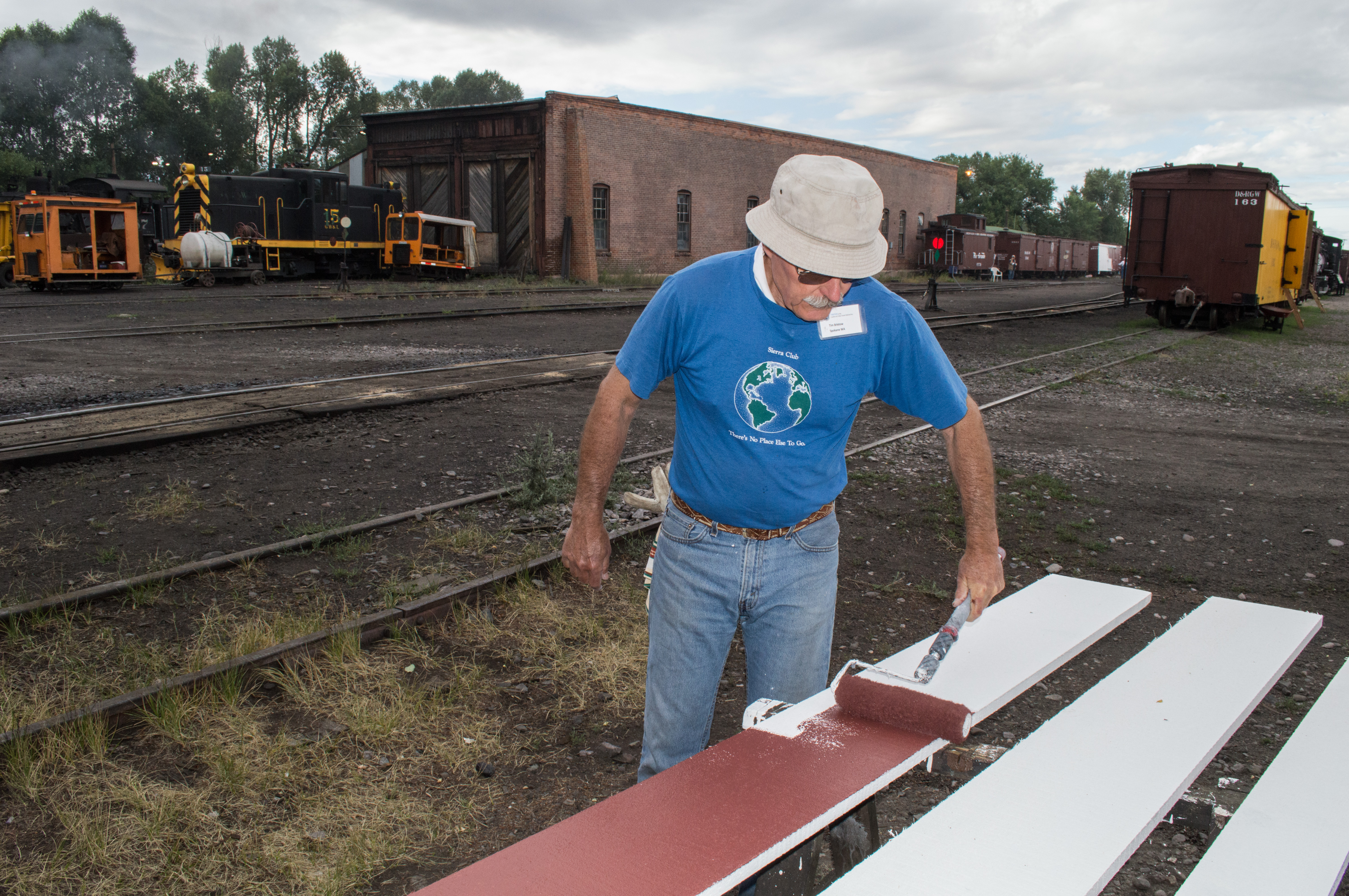

Tim is painting the roof walk boards

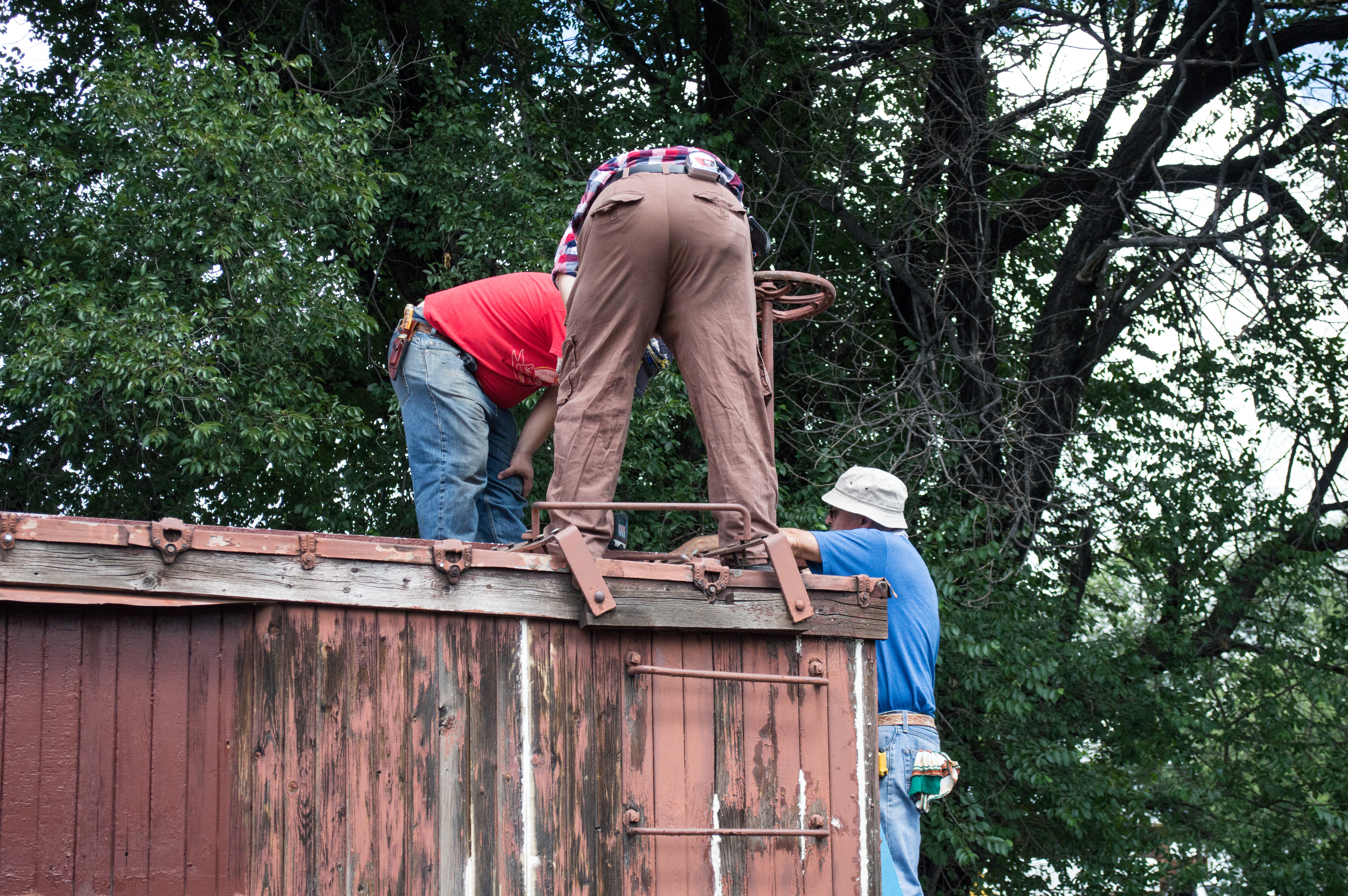

The crew is on the roof placing the roof walk boards before nailing them down
