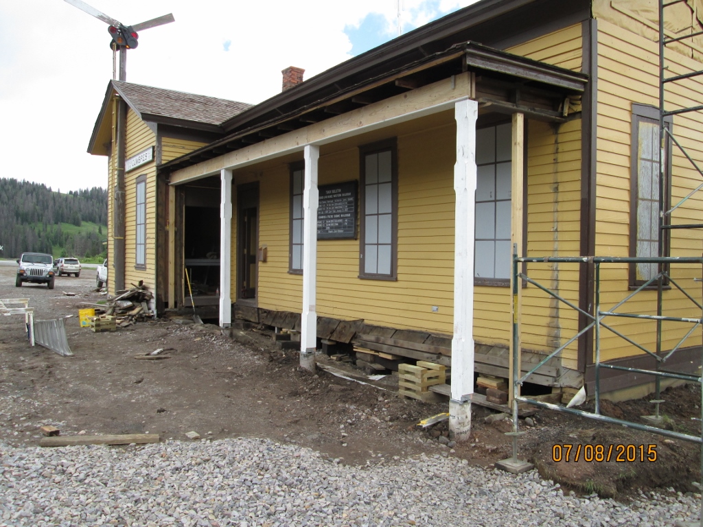

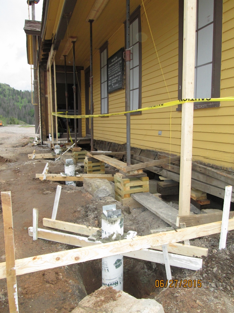

2015 Work Session "D" was successful in installing the first of three headers and digging three holes for the porch posts. Concrete was poured into the four foot deep holes to a depth of about 18 inches with rebar to establish a foundation for each post footing. Bob Conry is the lead for the Section House restoration and continued work on the facility after the Session. George Trever joined him to setup and pour the three footings. After a week of curing, the work to install the other two headers and all three posts started. Ron Horejsi joined Bob and George to get this key phase of the restoration activity. After many interruptions by rain, the porch roof structure was completed on July 8, 2015.

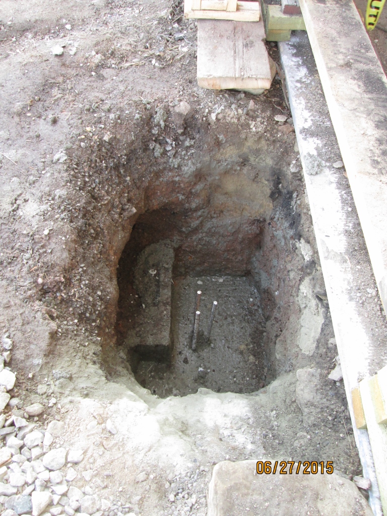

This was hole #1. All holes were 2'x2' and dug to four feet deep. This hole had an interesting surprise. It was a two-by like bin with a side that never ended. We had no clue what it was used for, especially at such a depth. It remained in place for the concrete pour.

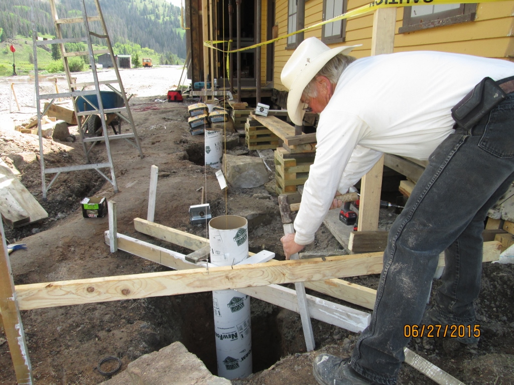

Bob was putting the finishing touches on the form for one of the posts.

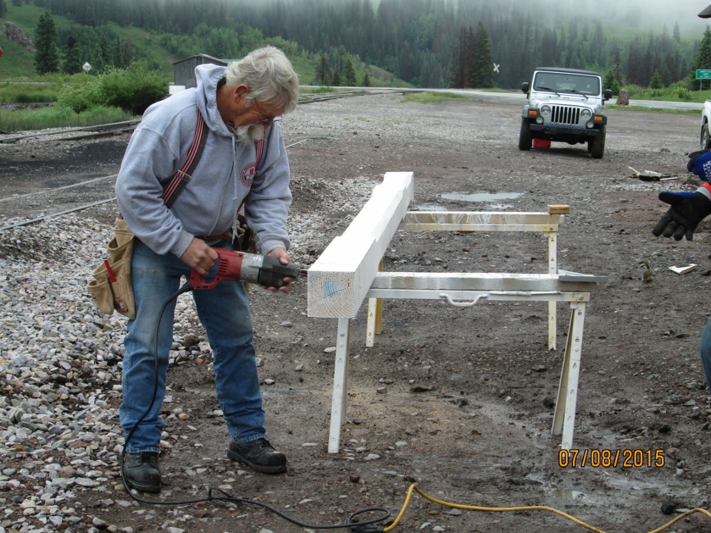

Bob makes the final cut on one of the posts. All three posts were cut to length, trimmed for the base mounting brackets and then put in place. Bob laboriously tweaked each header and post to achieve a nice straight alignment of the posts.

Finally, in spite of the fog and cold breeze, the final post was put in place. The remaining portion of the deck was removed in preparation of framing of the replacement deck.
