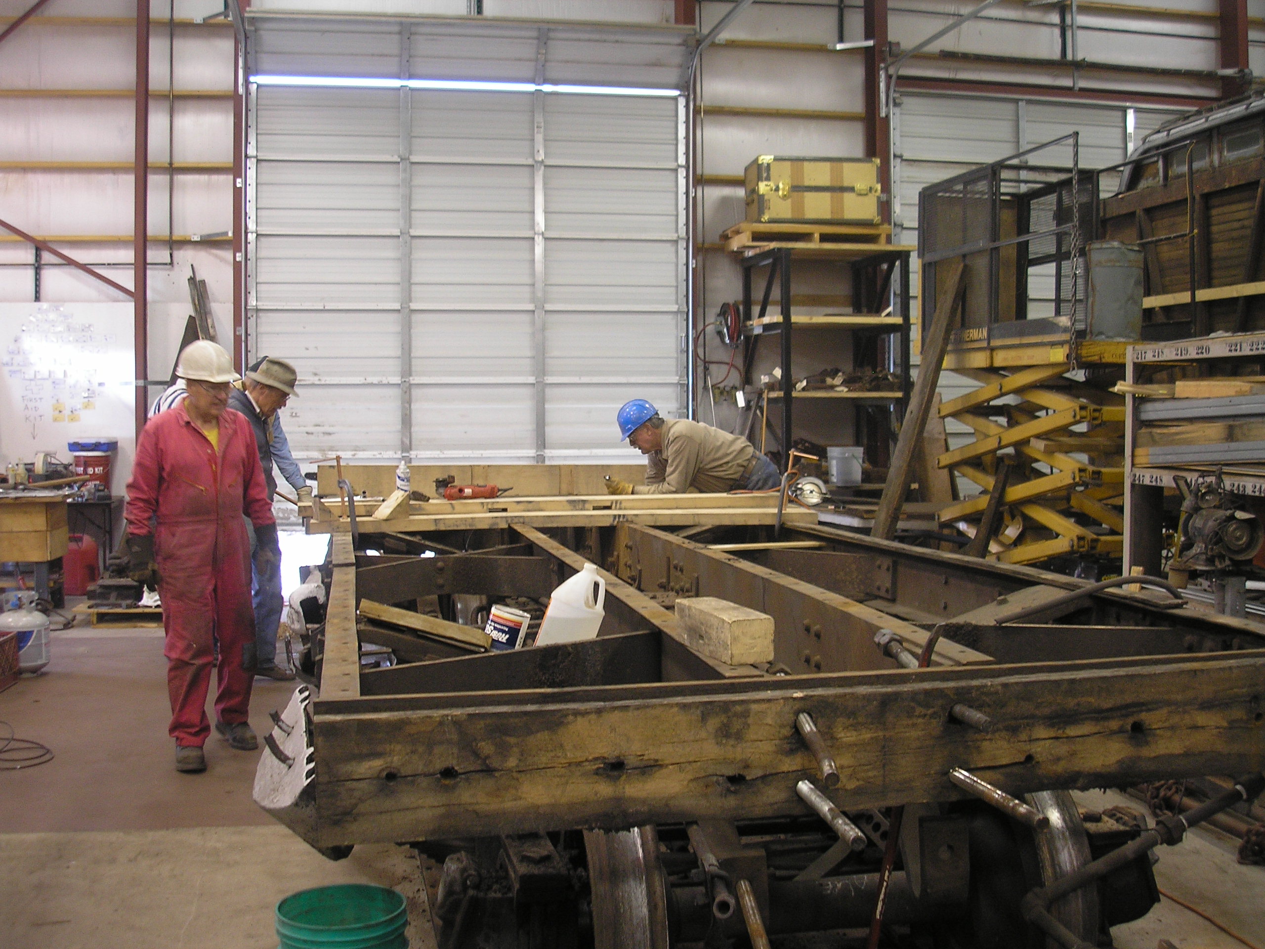

End of tender nearest locomotive before wood replacement.

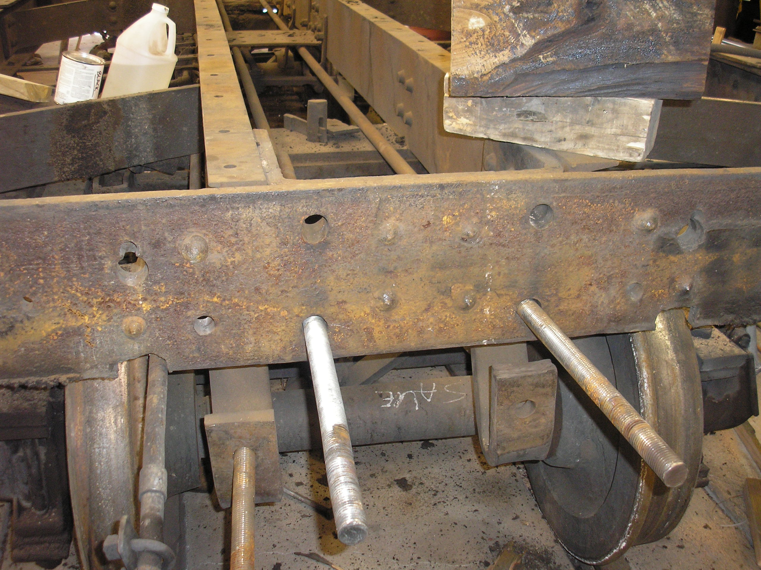

Old wood taken off frame.

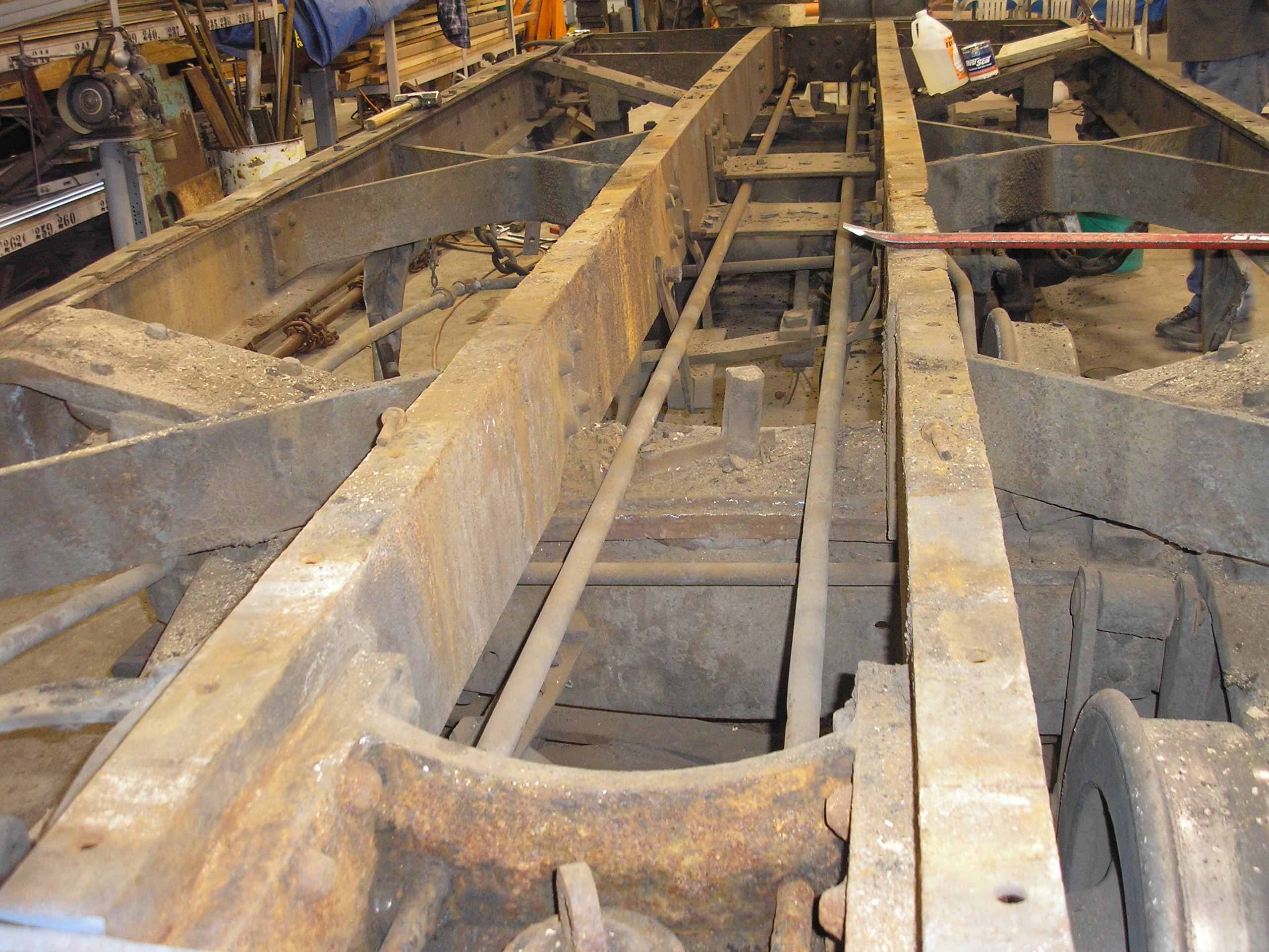

Unread postby Joe Kanocz » Fri Nov 25, 2011 2:47 pm

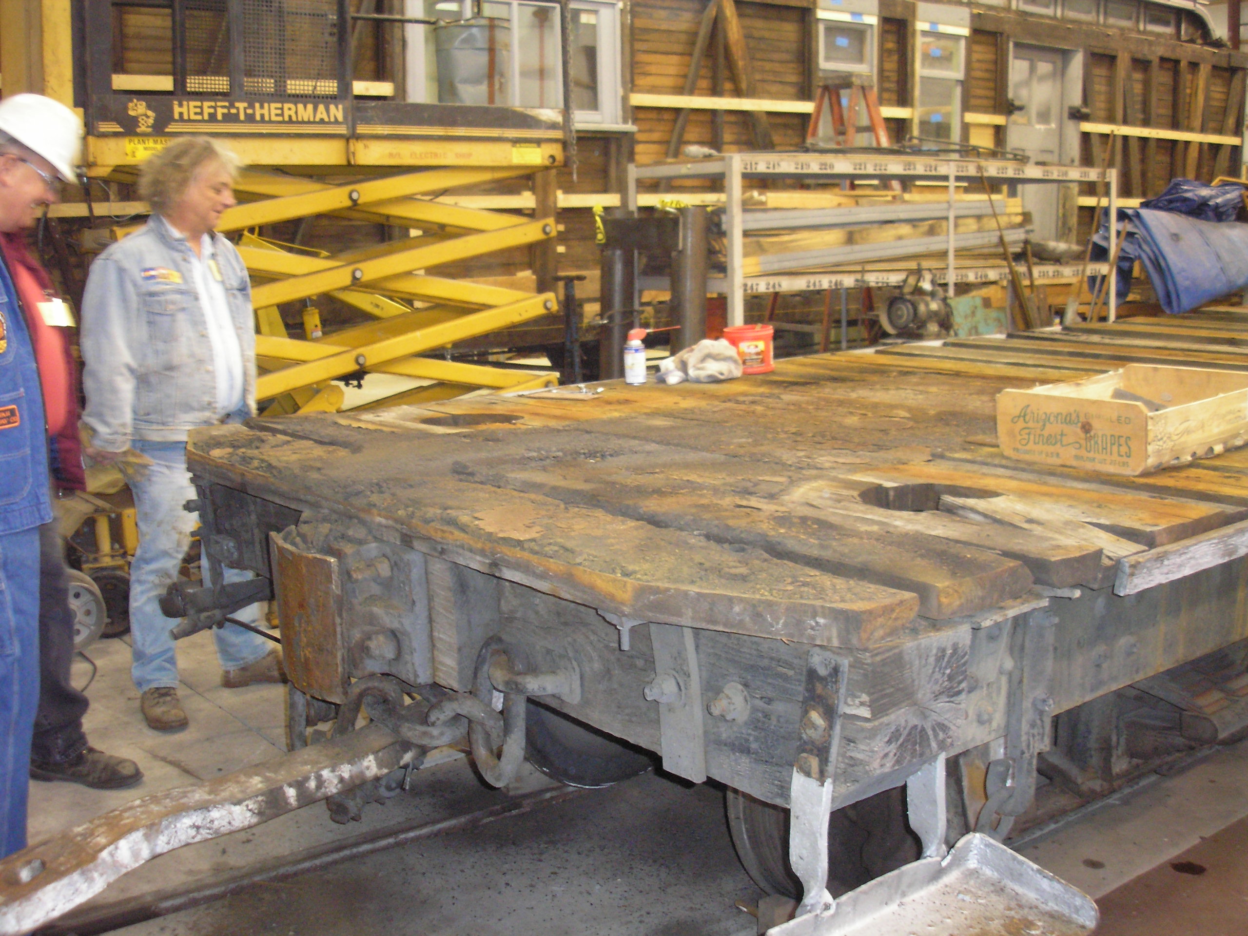

View of tender from the top. Notice the two metal rods appx 1" in the center. These rods are what carries the tension from the locomotive through the tender. This way the frame avoids undue tension and stress.
Re: Tender work session Antonito Nov 4, 2011
Unread postby Joe Kanocz » Fri Nov 25, 2011 2:50 pm
End view of the rods. When you ride behind the rebuilt 463, these rods are what carries the pull of the locomotive through the tender to the coupler.

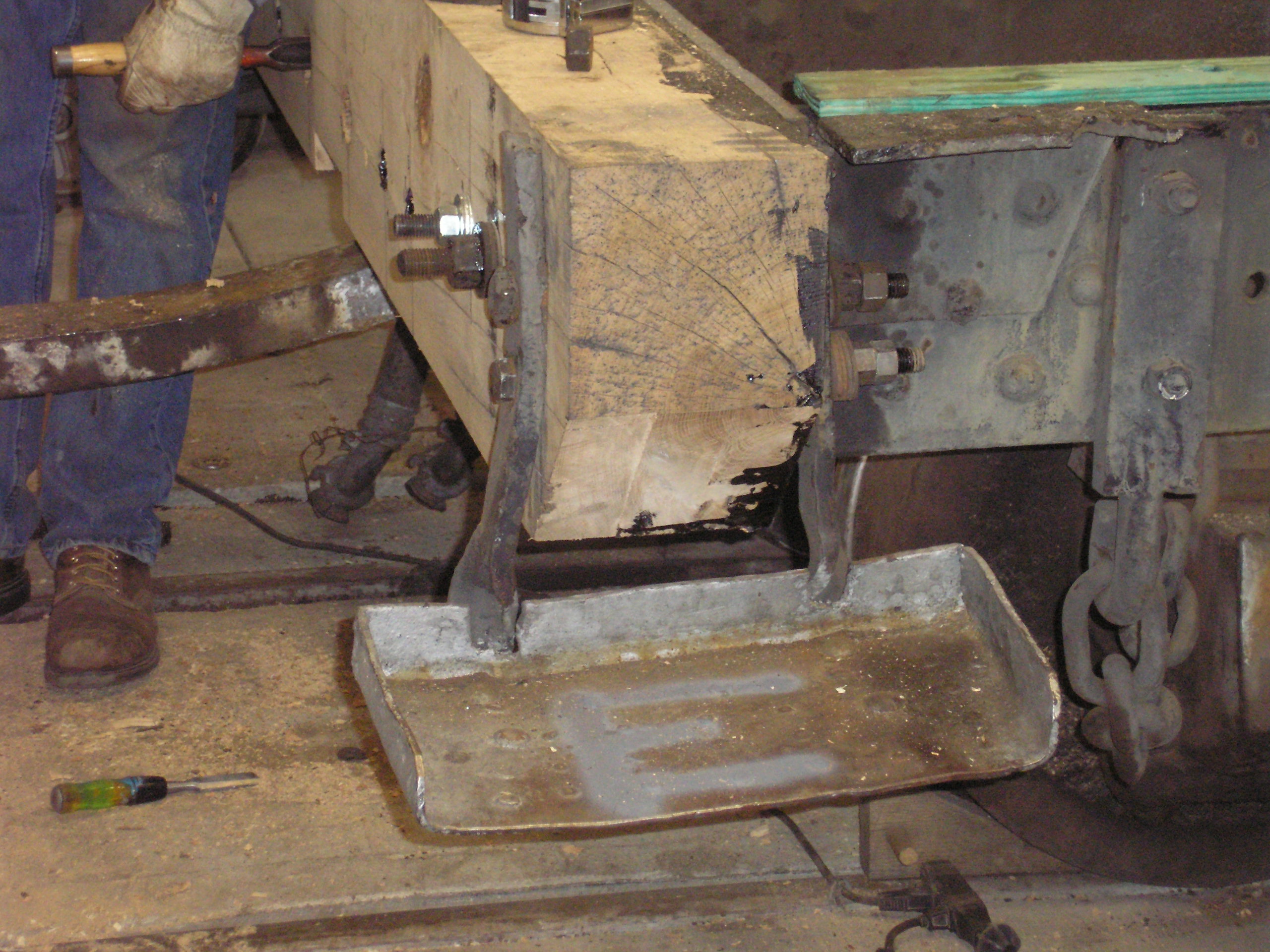

Unread postby Joe Kanocz » Fri Nov 25, 2011 3:03 pm

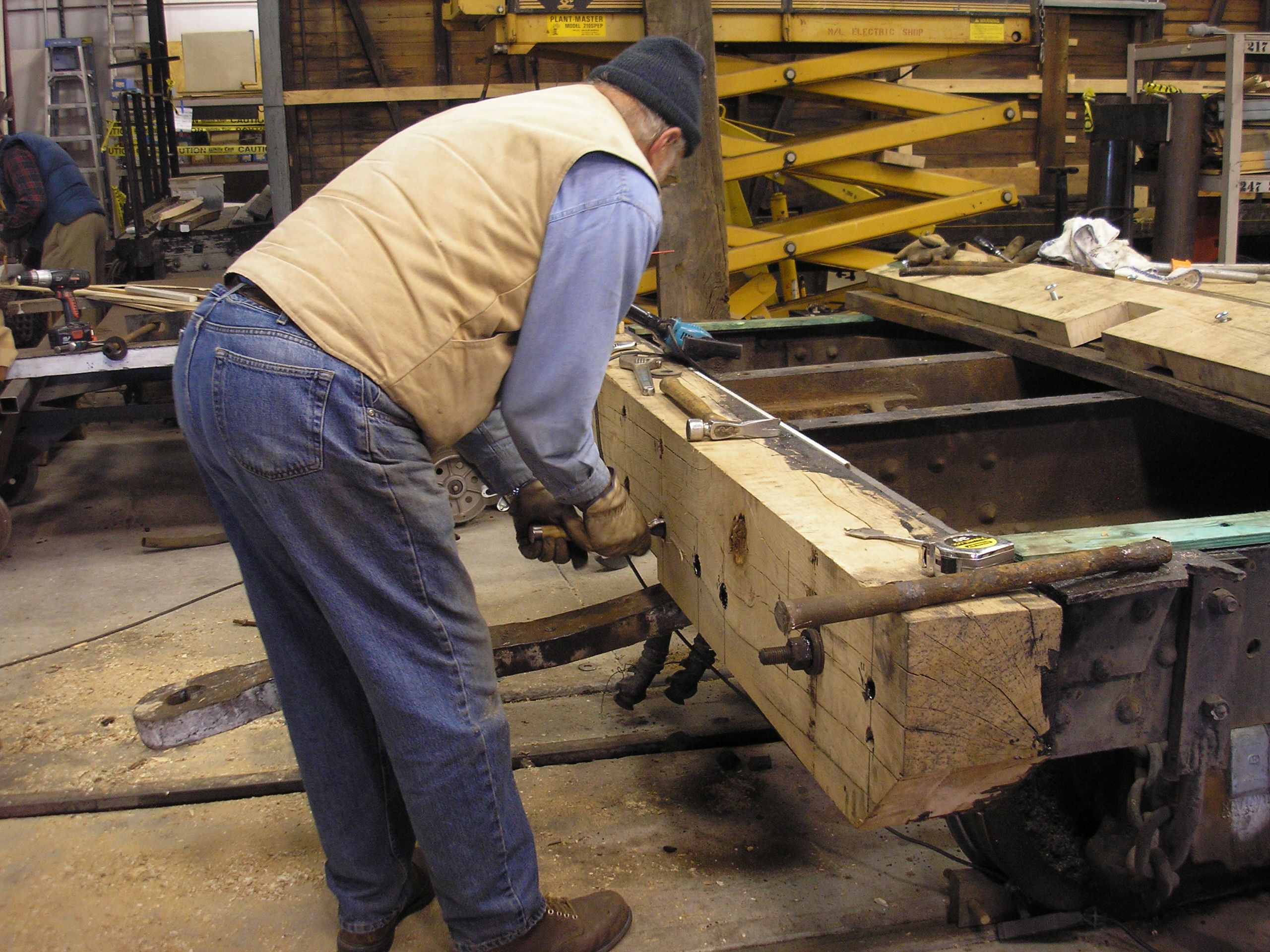

New white oak end sill installed.
Unread postby Joe Kanocz » Fri Nov 25, 2011 3:05 pm
Hardware being installed.

Unread postby Bill Kepner » Thu Dec 08, 2011 9:58 pm
Looks like the correctly figured out that the steps marked "E" belong on the engineer's side of the tender.

Unread postby Joe Kanocz » Fri Dec 09, 2011 7:12 am
That was a very clever system, huh :)
